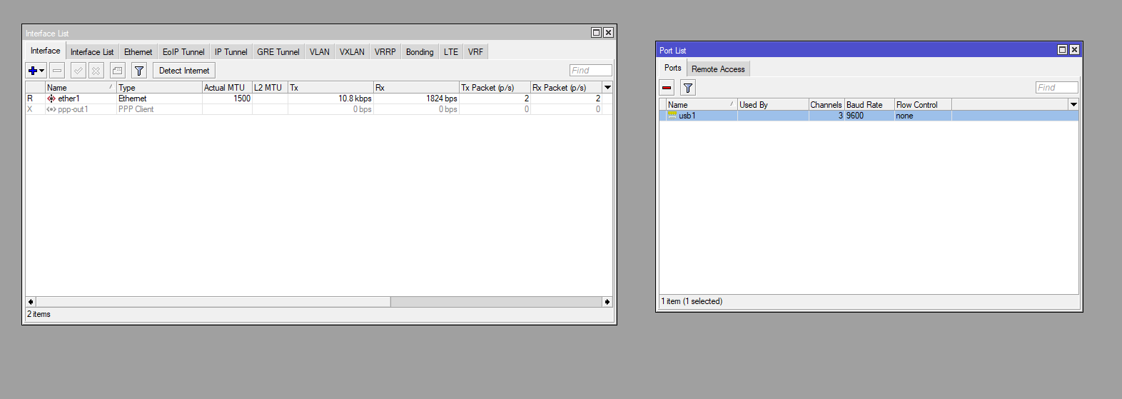

i have a Fibocom L850 LTE module which works fine under linux in mbim mode with a usb3 adapter. When i connect it to my x86 machine with router os v7 beta it is recognised as PPP interface and no LTE interface brings up. What can i do?

Help please: I have a Fibocom L850-GL modem, usb3 adapter and RB5009 (ROS 7.13.5). When I connect the modem to the router - LTE interface does not appear, in system/resource/usb the modem is visible, in ports/usb it is written in red usb1 and port inactive. No AT commands can be entered.
On PC the modem works, it connects to the network. Modem mode is MBIM.
The following is written in the logs: lte2 mbim: error: wdm send failed: 19
