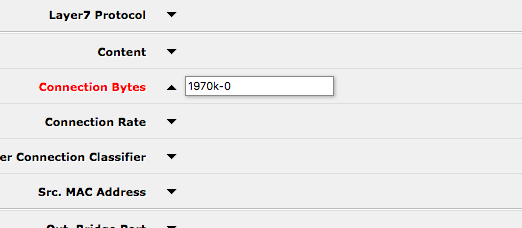

And another question:
add action=add-src-to-address-list address-list=Src address-list-timeout=1h
chain=forward connection-bytes=1970000-0 disabled=no protocol=tcp
src-address=192.168.0.0/24
The input in the web interface is incorrect. What is wrong?

Edit: And about connection-bytes option, congratulations, it looks like you found a bug in WebFig. It works correctly in WinBox and CLI.

@Sob, my brain is tired, been fighting with L2 fiber provider all day for poor service, but just so I can follow, I can’t see what is wrong in the webfig, it shows 1970k instead of 1970000, which seems to be correct according to my current tired brain?
