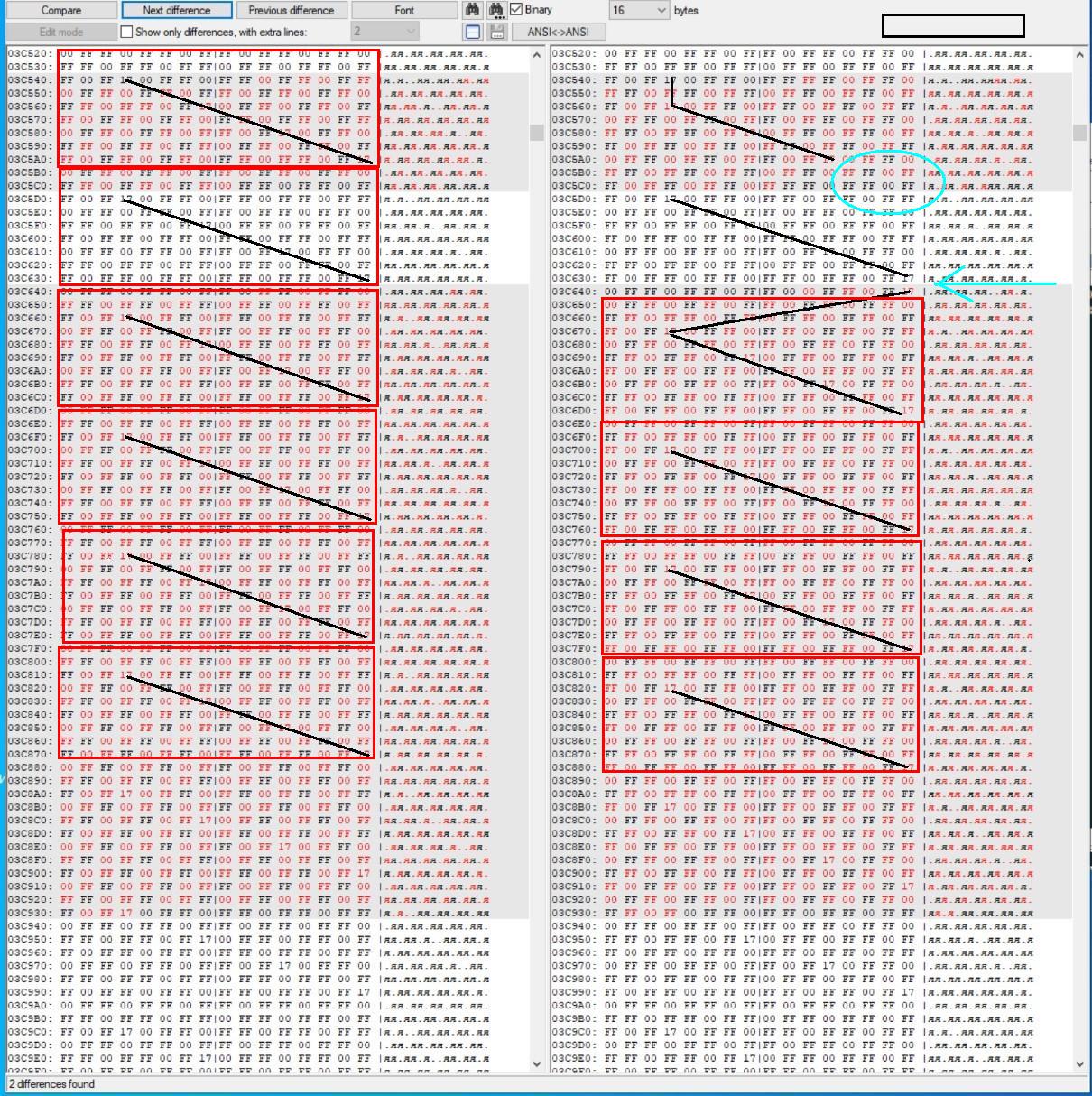

Sometimes, when I unpacked archives on another machine and outside the server room and the network in it, it turned out that the files from the archive started working, we placed them pointwise in shared folders (restore) and then I started comparing the damaged files and the files from the archive (restored, so to speak) in the HEX editor and found differences in them (on the screenshot in the application, the damaged file is on the left, the correct one is on the right). What caught my eye was that this was something similar to a simple bit inversion, but not always.

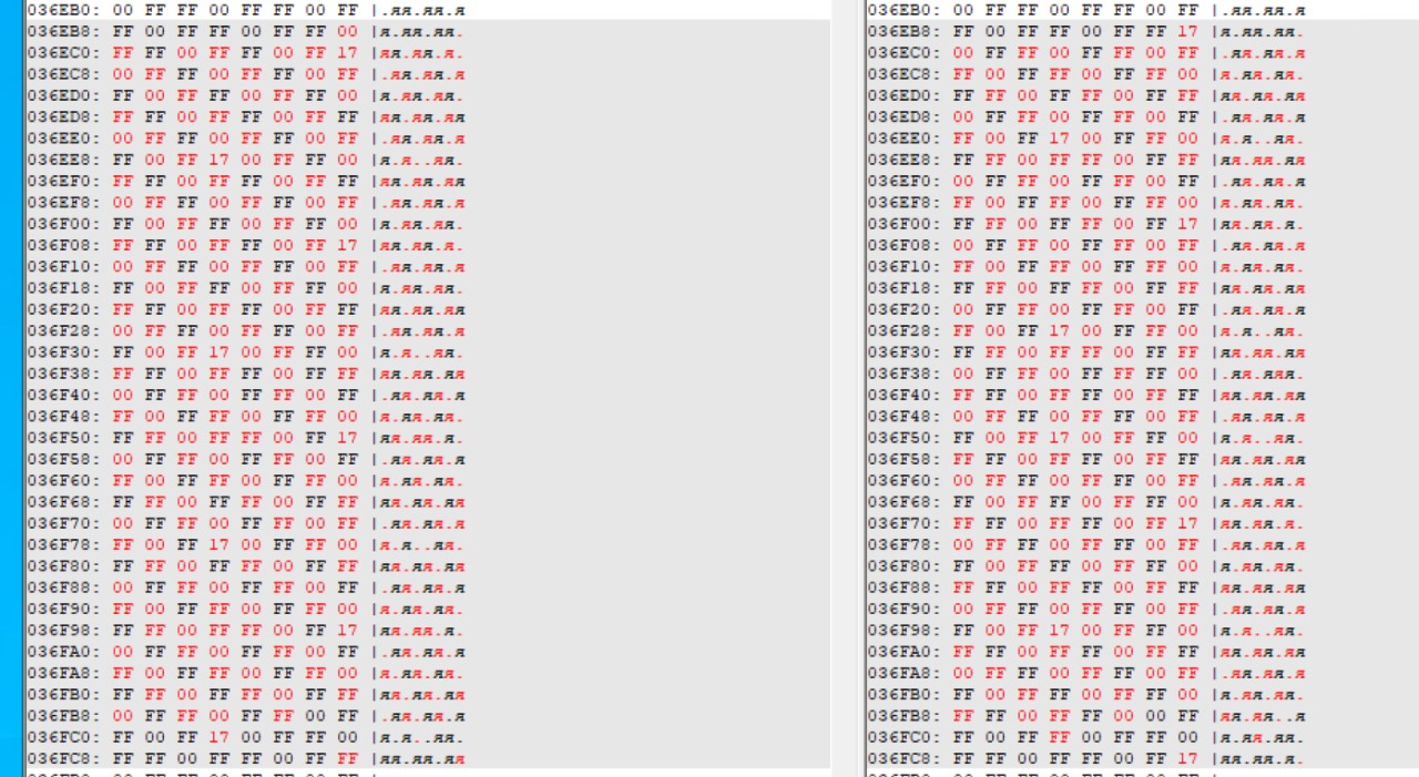

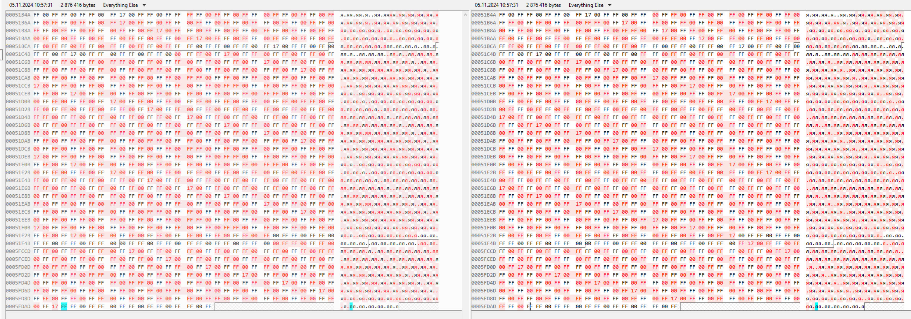

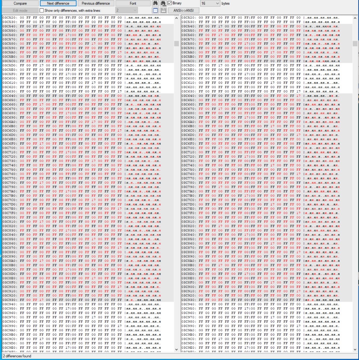

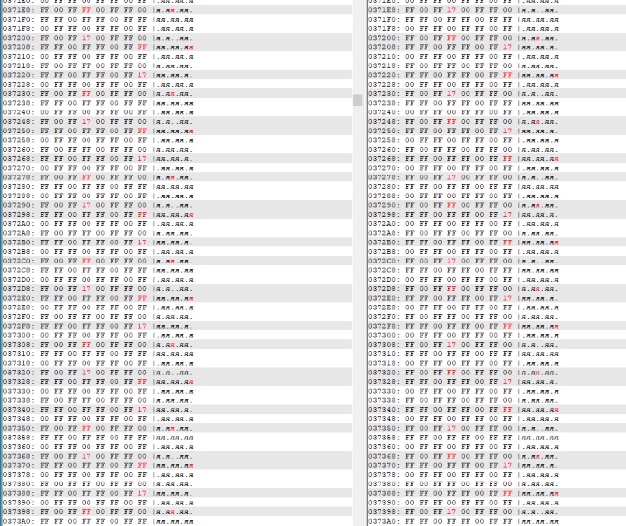

But I can say for sure that the problem is specifically in the part of data transmission over the network, and it only manifests itself with certain data patterns, maybe someone will be able to discern a pattern in the screenshot in the attachment.
Several screenshots for analysis

The original pattern seems to be a repeating 4 sets of 12 triplets, with 11 triplets 00FFFF and 1 00FF17.
With a hex view in 16 columns the global pattern is every 9 lines, 16x9=144 bytes, 144/12/3=4
The corruption on the file is strange (see image).
Yes, but based on this data, without knowing how the internal algorithms work when transmitting a packet, it is difficult to find out the cause of data corruption.
PS: once, in the early 2000s, when I was a student, I came across an article that a certain file was found that was impossible to write to a CD disk, a certain sequence of bytes (bits), which after being processed by the drive’s “brains”, looked like a signature of the beginning of a data sector on a CD, thereby hanging the drive during recording such a sequence. I’ll send you a link in Russian, if you are curious, read it, here, I think, something similar happens under certain circumstances. (https://www.ixbt.com/optical/magia-chisel.shtml)

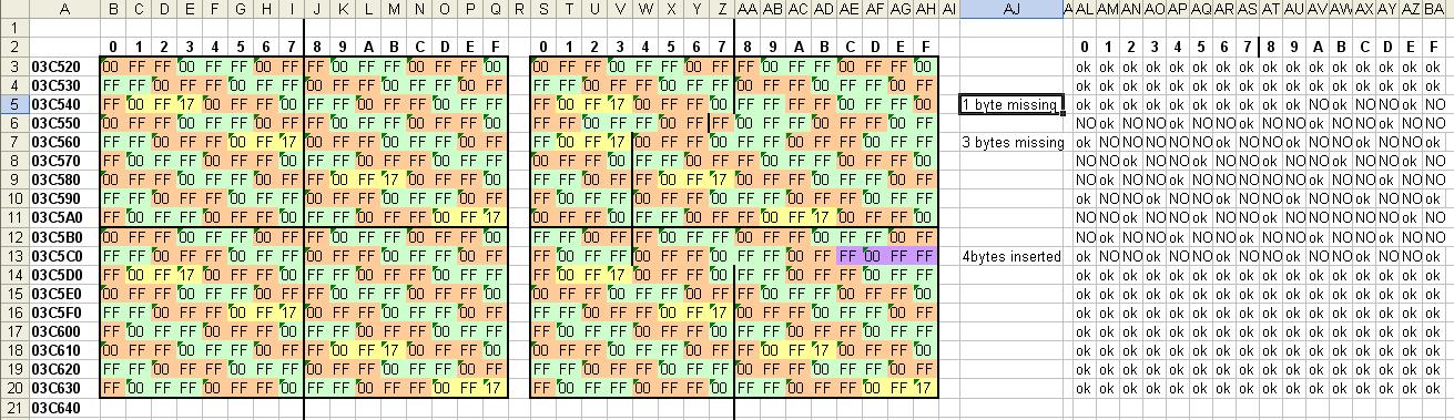

Yep, but what I mean is that I am failing to see a “corruption pattern”.
on line 03C540 there is a missing 00 byte (thus data is shifted by one byte) on positions 8-11, 4 consecutive FF bytes should mean that.
on line 03C560 a whole triplet is missing
everything seems shifted up by 4 byte until line 03C5C0 where 4 bytes magically appear out of nowhere and the “17” pattern synchronizes again.
A 00 vs.FF or viceversa can be a XOR or bit flipping, but 17 remains the same.
The next difference seems like a completely different pattern, seemingly bytes are inserted and everything is shifted 16 bytes down.
