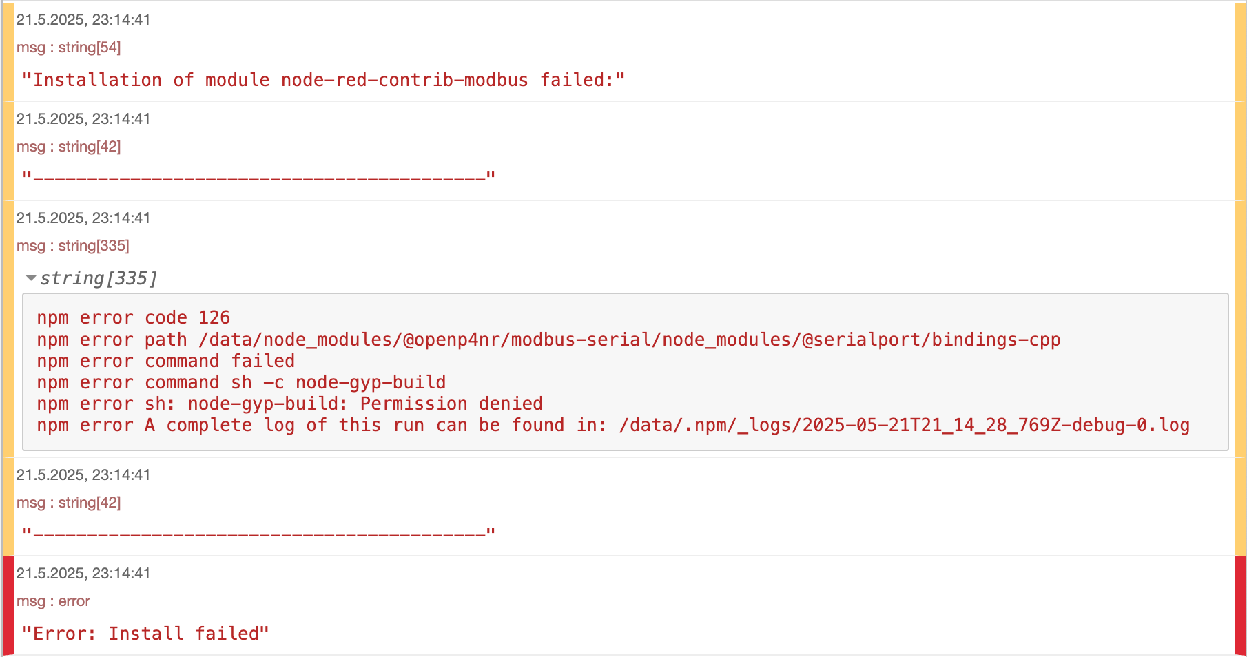

I’m trying to install the node-red-contrib-modbus package inside the container, but I’m encountering a strange issue:

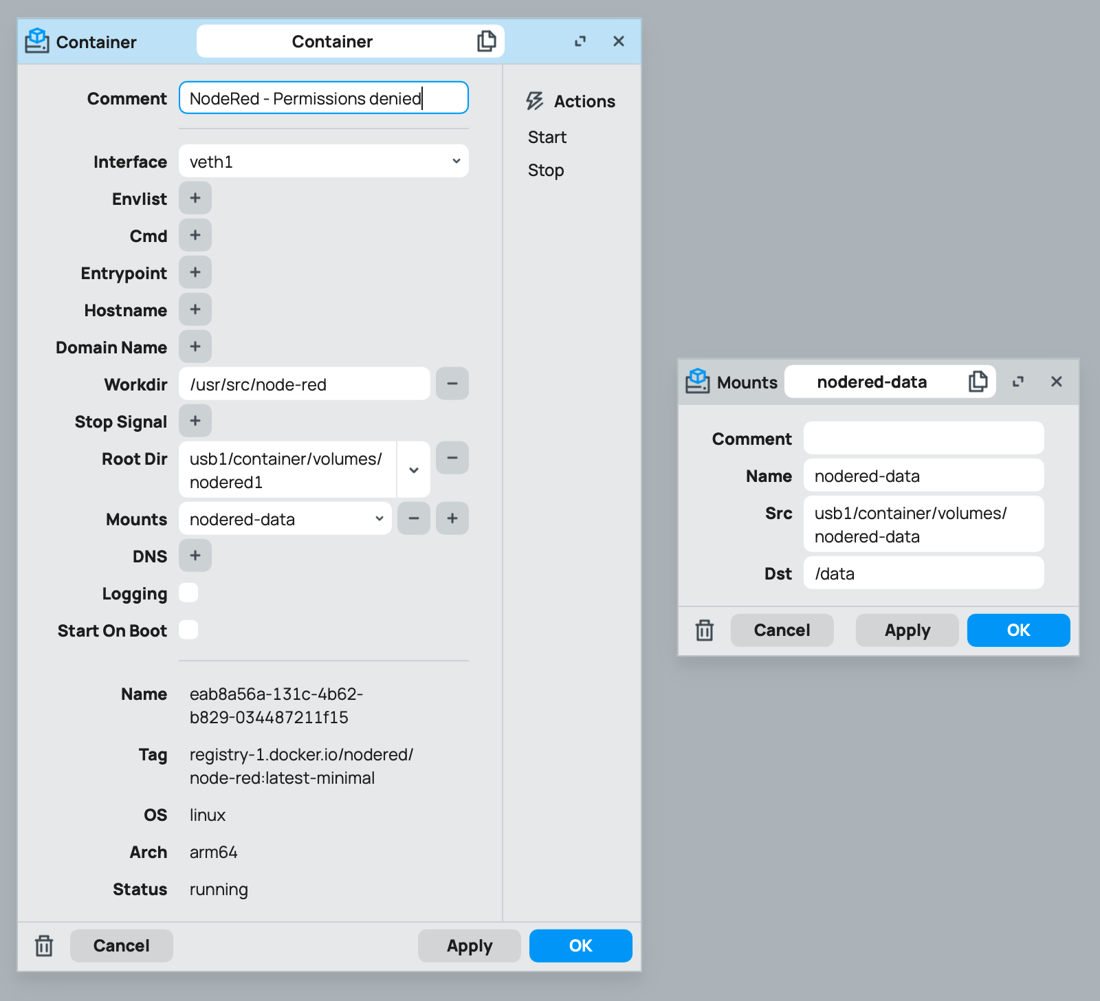

With a mounted volume: I get a “permission denied” error during the installation of the package.

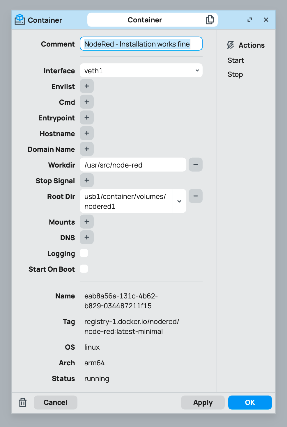

Without a mounted volume: The installation completes without any issues.

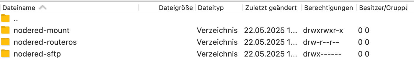

I have created 3 folders.
Folder one (nodered-mount) i haven´t created myself, i just added the path on /container/mount and let it create the folder. Permissions=775
Folder two (nodered-routeros) i created with /files. Permissions=644
Folder three (nodered-sftp) i created with sftp. Permissions=700
With Folder one the container starts, but i can not install the addon.
With Folder two and three the container does not start (Permissions to create a setting file denied)
I have tried to change the folder permissions with sftp but it does not let me. The permissions stay the same as before.
Is there any other way to change file permissions?
You can attach the drive to a pc or try smb.

However, as soon as I use a mount for /data, I get a “Permission denied” error when trying to install the addon.
