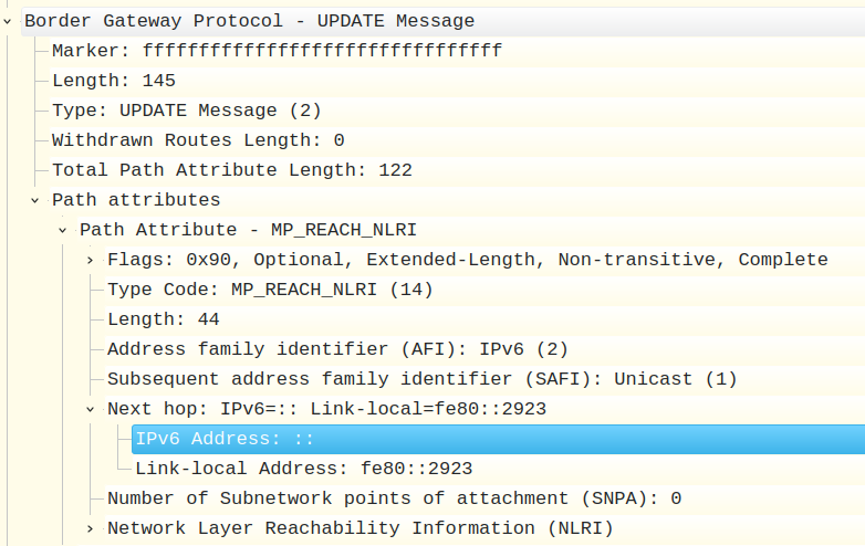

I got two BGP peers, using only link local. Before I tested the setup, and it worked perfectly. Of course, this means it broke when put in production.
The two attached files show the problem: BIRD sends TWO addresses on the “Next Hop” field. The link local address IP and one “::” (since this P2P link only uses link local). ROS sends ONLY the link local IP.
And RoS is choking on this, thinking that the route doesn’t have a gateway. I solved this with a one liner filter, but it is different for every peer. I would like some help to create something that I could just use to everyone.

It’s the second image, the one named “One Mikrotik to another”. The first message shows a Mikrotik talking to a Bird. The difference is in the “Next Hop” line.
yes. that’s what i have thought.
from those 2 images - are you sure you are not twisted? i think that bird didn’t send mt its (bird) ipv6 nexthop.
my guess is mt’s routing table is correct in this particular issue.

Clarifying what Bird does.
Bird sent “Next Hop: IPv6=:: Link-Local=fe80::2923”
RoS chocked on that first “::”. Funny thing is: RoS is in the right here: the drafts say to do what it does, and Bird do this weird thing for some time - I found some frr bug report with the SAME issue (https://github.com/FRRouting/frr/issues/6259)
