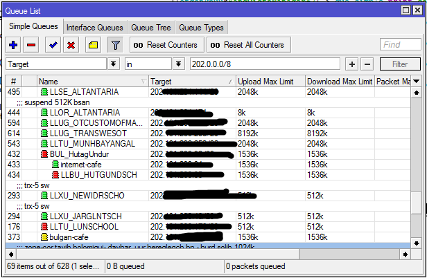

I tried to find (or print) simple queue with target in network 202.0.0.0/8. Using Winbox, it`s easy to find using filter option like
But I can not do it using CLI (/queue simple print count where target in “202.0.0.0/8”). Please help me to do this. Based on this command, I will create my script that finds specific queues and creates those addresses in address-list. Basically firewall filter rule, that allows traffic if it is created in simple queue.
