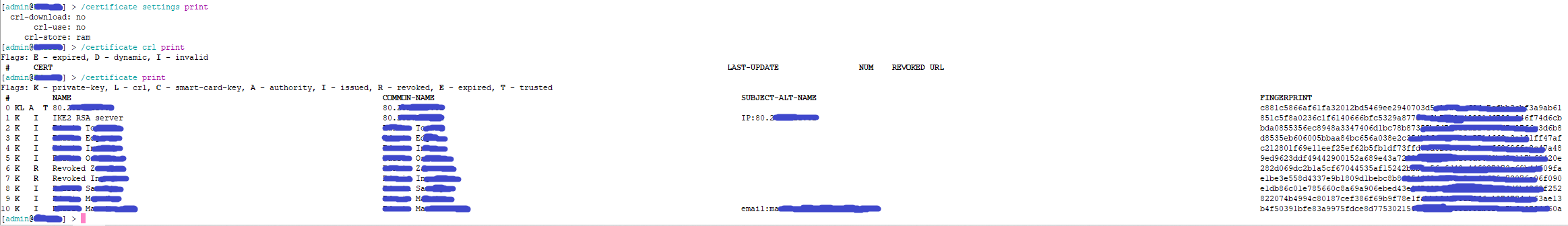

Your /certificate crl print shows an empty list, and under /certificate settings, use of crls is disabled. Hence when inspecting a certificate received from an initiator, the responder does not look for it on the CRL. There is no point in having two mechanisms for that, so there is no “shortcut” to locally issued certificates. See this for more details.
But this should not be a problem in your case, given that you don’t have any identity items that do not match on a particular certificate.

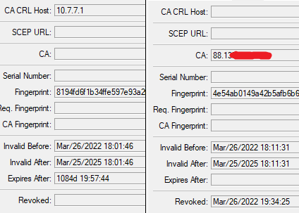

I did a couple of tests on my home router last weekend. I’m not entirely sure if it’s really necessary to set crl-download to yes in my case, but after I set crl-use to yes and performed the following configuration, I was able to make the router to recognize if the certificate has revoked.
/certificate
add common-name=XX.XX.XX.XX name=XX.XX.XX.XX
sign "XX.XX.XX.XX" ca-crl-host=<router local IP>
add common-name=XX.XX.XX.XX subject-alt-name=IP:XX.XX.XX.XX key-usage=tls-server name="IKE2 RSA server"
sign "IKE2 RSA server" ca=XX.XX.XX.XX
add common-name=Client name=Client key-usage=tls-client
sign Client ca=XX.XX.XX.XX
export-certificate Client export-passphrase=SuperStrongPass123 type=pkcs12
I usually specify Days valid value identical for client and CA certificates, so I think crl-download is not needed for me. If I need to revoke certificate, I always do it manually.

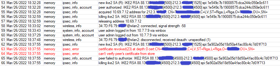

Here you can see that after revoking the certificate, I was no longer able to connect to the VPN.
