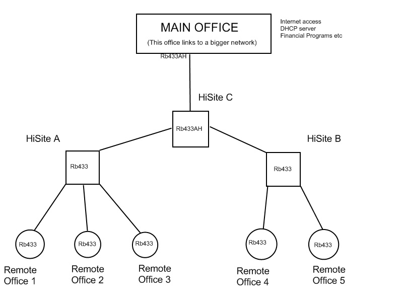

I have attached a very rough simple diagram of the layout.
Bar, the remote offices, the remainder of the links are point to point. You mentioned Wds, but is that also the correct option for the PTP links?
The Remote Offices have an average of 1-5 computers.
They have given us one IP subnet range to work with within their bigger network.
I’d like to do routing on this.
Could you in your experience, look at the diagram and advise me as to best setup?
thanks in advance.

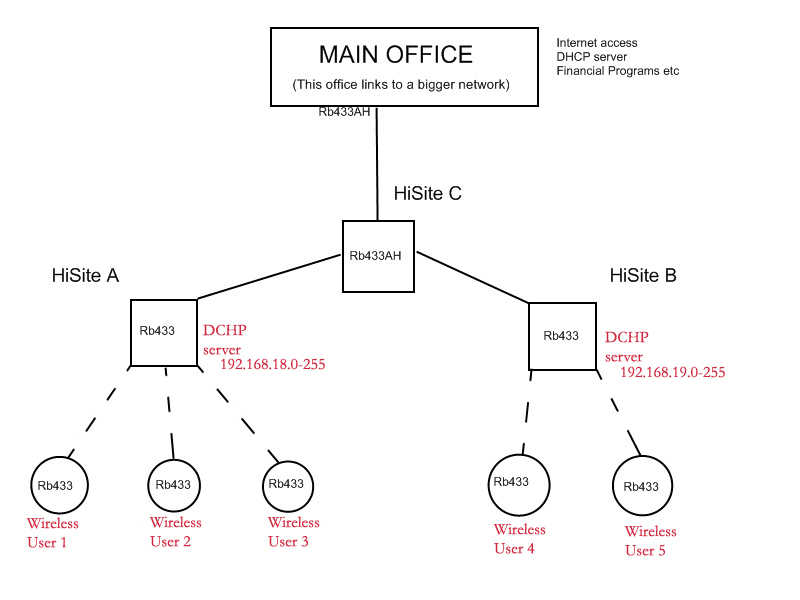

I agree with Tom, you can use bridge.
If HiSite A and HiSite B were access points running DCHP server,
is there a way for Wireless User 1 running winbox to connect
to the mikrotik router card for Wireless User 5 ?
I’ve broken our network into 5 access points with each ap being a DCHP server with 10- 20 users connected to each ap.
