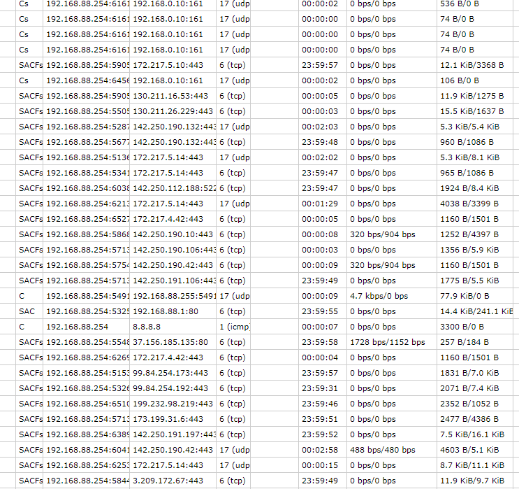

When I can fool the FireTV Stick to get me into Netflix, Netflix says it sees the Internet, BUT the 3 Netflix servers are not reachable. I did watch the connections and can see it trying to connect the servers, but getting 0 bytes transferred
By the way, this isn't happening on just one Mikrotik, it's all of them using Verizon. (But remember, I pull these SIMs out and place in a GTEN Router and it works fine.) I've also tried all 4 available firmware including the latest Beta just to make sure it wasn't something fixed in a firmware update. Other known things that are being blocked, a weather station and house thermostats. Also, multiple generations of FireTV Sticks including a 2021 Edition, all running the latest updated software.
