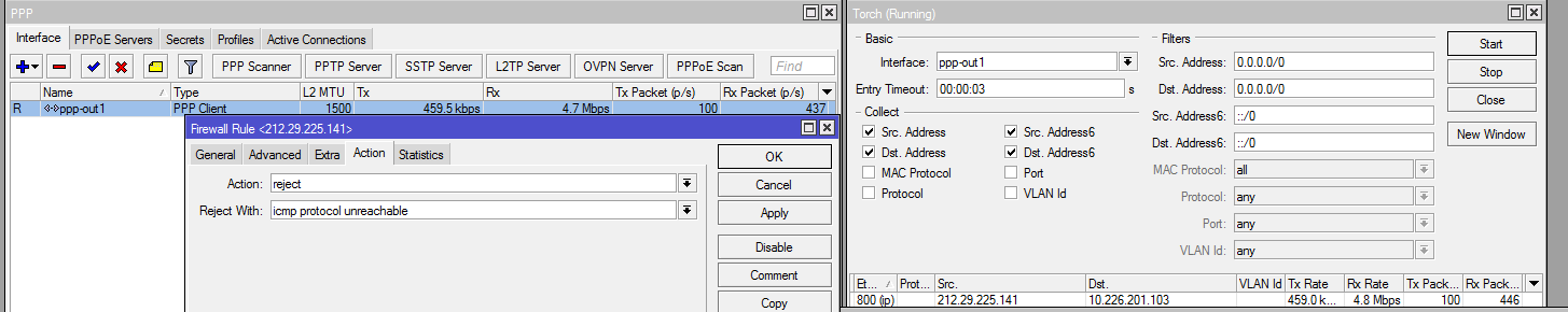

even if nothing is connected to my router , I can see that there is a RX of 3-5Mbps
when I do torch I can see that IP is connecting to my router in 3 port
and downloading from it 2M in each port
when I make a firewall rule and try to block this IP
add action=drop chain=input src-address=212.29.225.141
I can see the counter is increasing but the data is still growing , and the IP is still connected
how could it be?
what am I missing\ doing wrong?
you mean the 4.9GB data? It is increasing because those traffic is still arriving your router, then being dropped at the router.
try reject instead of drop.
Tried it ,
still I can see connections and data
This is expected behaviour. Torch shows all traffic even if it later gets filtered by the firewall.
I think the question here is how to get rid of this connection. yes it get dropped but still use some of the uplink bandwidth, isn’t it?
Someone correct me if I’m wrong, but I see no evidence so far that the 5Mbps of inbound traffic is not destined for an internal host. Check IP > Firewall > Connections for a traffic flow being initiated by an internal host to that IP.
If not, then you may be receiving DoS traffic.
The 459kbps outbound in the screenshot where you are rejecting the traffic seems excessive for ICMP unreachables. The ICMP packets are about 574 bytes each. I don’t recall offhand if some of the original packet contents are included in the ICMP packet or not. Perhaps so. In any case, I’d switch back to drop. No need to send unreachables if the sending host is going to ignore it. If you’re seeing DoS traffic, the 212.29.225.141 is probably not the source anyway.

  1. I have check the firewall connection - and nothing is going to this address , I have even turn off the ethernet&Wlan connection - and still there is a data going on the ppp-out.
  2. the problem is that it’s “wasing” all my data plan - and I ahve notice in the last 4 days it’s been 190GB… , so I need to turn it off
  3. it there any way to know which address from this IP is doing the spam? , for example to see that computer with IP 192.168.1.5 - he is the one that sending it?
  4. what are this ports? never seen them ?
  5. what can be done in order to disable this activity ? - I can’t belive it can be fix…
Thanks ,
