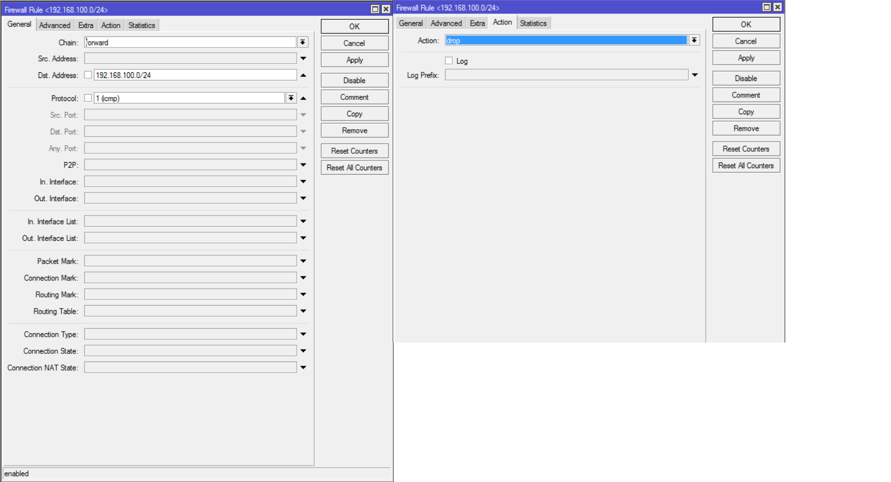

I have more than 300 u*nt antenna connected to mikroitk 1036 4s . I try to block All ip addresses reach and ping to these all 300 antennas. But Filter rule doesnt work please could you tell me what is the problem.

This rule work for 192.168.101.0/24 . But doesnt work for 192.168.100.0/24. I think there is bug.

I have two rules.
1)Action=drop Chain=forward dst-address=192.168.100.0/24 protocol=icmp
2)Action=drop Chain=forward dst-address=192.168.101.0/24 protocol=icmp

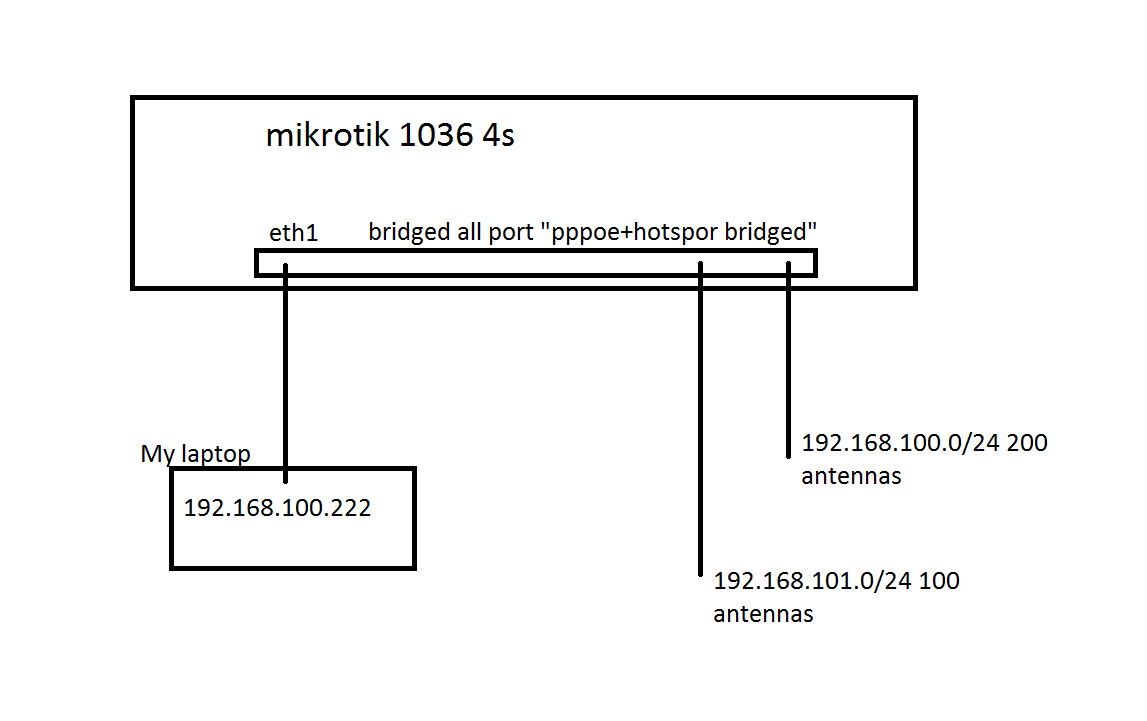

There is one problem about pinging. There is two stuations.
When My ip 192.168.100.X I cannot ping to 192.168.101.0/24 But I can ping 192.168.100.0/24
When My ip 192.168.101.X I cannot ping to 192.168.100.0/24 But I can ping 192.168.101.0/24

Your pc on ethet1 worries me though. Is that port bridged with the rest? If not, you should not have an address 100.x/24. You should be on a different subnet. Then your rules will work all the time.
My understanding of your setup is that you dont want other people pinging the APs. If so, that pc has to be on a different subnet.

Dont think only for eth1 ı have 8 port bridged . And ı have 192.168.100.x/24 and 192.168.101.x/24 described to this bridged. I dont want any ip address try to check another ip . İf user use static ip it doesnt matter what dhcp gives him. So he can use static ip from 192.168.100.x/24 and ping to other customers.
