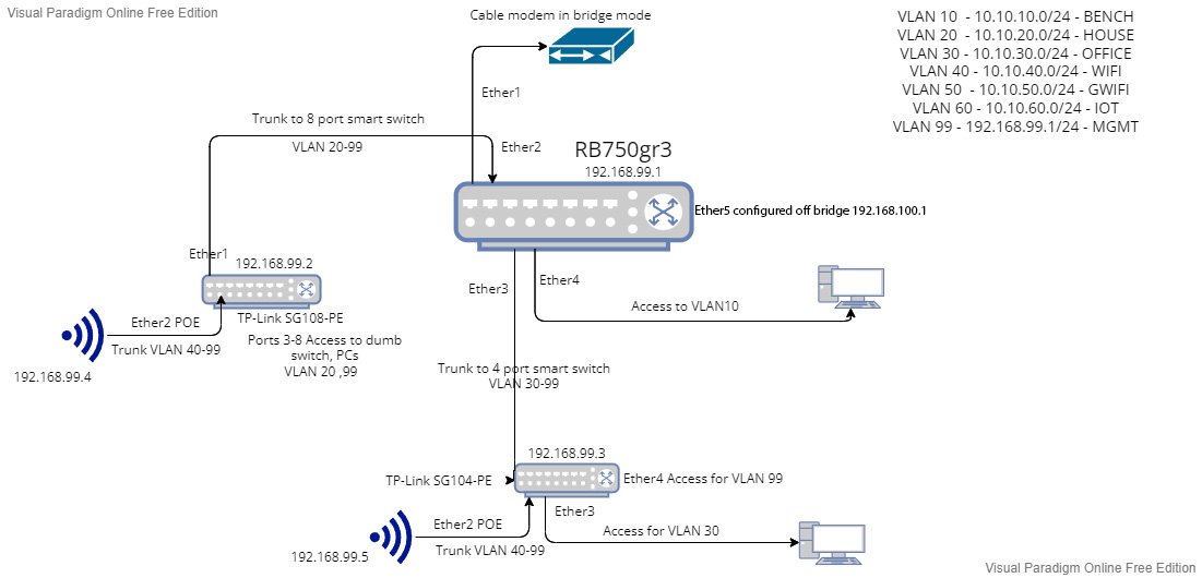

As an aside, I got the RB750gr3 thinking it would be a good device to isolate the house into vlans without realizing not all switch chips were vlan capable at the hardware level. Think it will still do the trick in software for <20 devices, maybe 6 vlans?

Before I attempt this, addressing etc aside, I just wanted to verify I am using the correct commands/syntax to construct the VLANS for this:
/interface vlan add interface=bridge1 name=Bench vlan-id=10
/interface vlan add interface=bridge1 name=House vlan-id=20
/interface vlan add interface=bridge1 name=Office vlan-id=30
/interface vlan add interface=bridge1 name=Wifi vlan-id=40
/interface vlan add interface=bridge1 name=Gwifi vlan-id=50
/interface vlan add interface=bridge1 name=IOT vlan-id=60
/interface vlan add interface=bridge1 name=Mgmt vlan-id=99
/interface bridge port add bridge=bridge1 frame-types=admit-only-vlan-tagged ingress-filtering=yes interface=ether2
/interface bridge port add bridge=bridge1 frame-types=admit-only-vlan-tagged ingress-filtering=yes interface=ether3
/interface bridge port add bridge=bridge1 frame-types=admit-only-untagged-and-priority-tagged pvid=10 interface=ether4
/interface bridge vlan add bridge=bridge1 tagged=bridge1,ether2,ether3 vlan-ids=10,20,30,40,50,60,99
Or have I completely misunderstood?
Looking good thus far…
The TPLINK smart switches get IP addresses (set manually is best) on the management vlan, and set to static lease on the Mikrotik of course.
You can use ingress-filtering=yes for access ports, not just trunk ports
aka
/interface bridge port add bridge=bridge1 frame-types=admit-only-untagged-and-priority-tagged pvid=10 interface=ether4 ingress-filtering=yes
For /interface bridge vlans you can combine vlan-ids on the same line if all the noted etherports have the identical requirements.
This is not the case so you need to break it down a little bit more.
add bridge=bridge1 tagged=bridge1,ether2,ether3 untagged=ether4 vlan-ids=10
add bridge=bridge1 tagged=bridge1,ether2,ether3 vlan-ids=20,30,40,50,60,99 { none of these vlans go on ether4).

So for the /interface bridge vlan:
If all the ports were trunk that would have been OK, but you have to specify a single id per line if there’s an Access port in the mix?
So supposing there were 2 Access ports here it would require yet another additional line like this?:
add bridge=bridge1 tagged=bridge1,ether2,ether3 untagged=ether5 vlan-ids=20

Almost, follow the logic through
The mistake in yellow
add bridge=bridge1 tagged=bridge1,ether2,ether3 vlan-ids=30,40,50,60,99
