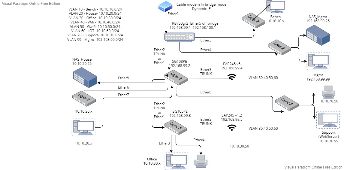

With some help from Anav, I have the VLAN syntax straightened out and they appear to be working fine. My intention is to segment the network like this:
Would a veteran be kind enough to review my config, specifically the firewall and point out what might be fundamentally wrong with it or any redundancy etc. before I move all the hardware to it’s “forever home”?
