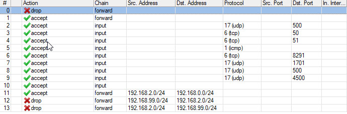

you have
/ip firewall filter add chain=forward action=accept
at the top of your forward chain, which means you forward everything.
any forward rule after this is ignored. including your blocking attempts.

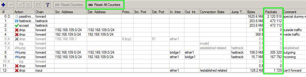

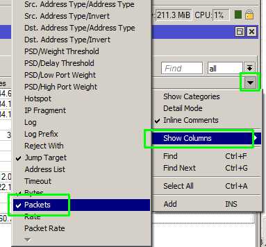

in order to see how often specific rules got hit enable the packet count column in WinBox:

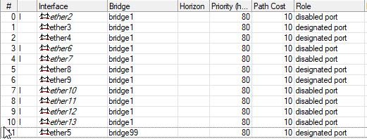

add address=192.168.2.1/24 interface=ether2 network=192.168.2.0
add bridge=bridge1 interface=ether2
c. Compare this address rule to the listing in bridge ports, the interface should be bridge1

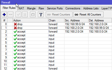

Hi anav!
I made the changes , you can see below:
Excellent, good news allround.
I would like a better view of your complete firewall rules, but if it works, no need!!
But how do you add images to your posts… something I need to figure out LOL.
