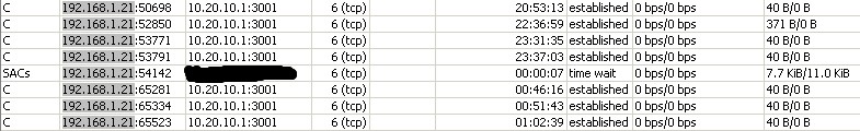

Now if this is a established connection, i think it should get caught by the first filter rule. So I checked the connections, and there it was:
And the interesting thing is that all other traffic works correctly, the only traffic that was logged by the eplicit rule I put in was the traffic from this pc at 192.168.1.21 to the server at 10.20.10.1:3001
The port on the client changes, but I checked all of them and they all have established connections in the connection tracker.

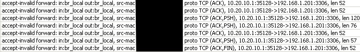

The problem was not just limited to these two computers. There were other problems with connection tracking between these two subnets.
For example 10.20.10.1 could no longer connect to MySQL on 192.168.1.201
I added a rule that explicitly allows invalid forward from the local bridge now and logs these packets.

accept-invalid forward: in:br_local out:br_local, src-mac <hidden>, proto ICMP (type 0, code 0), 192.168.1.201->10.20.10.1, len 84
