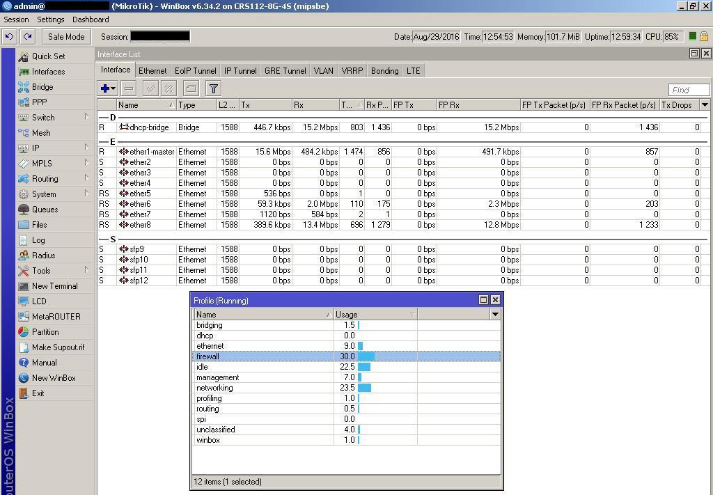

Firewall high cpu on CRS112-8G-4S
Hello, I recently purchased this nice cloud core switch. But the CPU is high all the time.
This is my config from my router. If someone experienced user can give me some help and hints, thank you all the best.

Try this:
Instead of adding the ports to a bridge, set ether3-8 as slave interfaces of ether2.
“Move” any IPs and services (DHCP-Server) assigned to dhcp-bridge to ether2.
That way you’ll be doing switching by hardware switch chip; right now you’re doing it by software, which taxes the CPU.
Yeah, you definitely don’t want to user bridging for what seems to be simple layer 2 operations. Better to not use bridging at all…rely on the switch chip for layer 2, and only use the CPU for routing. The CRS really isn’t meant for CPU intensive tasks like routing or bridging…the layer 3 functionality is really just there for management purposes. Think of the CRS more as a managed switch than a router.
Thank you for helping me , I removed the bridge, but unfortunately it’s worse, the CPU is much higher and the router is very slow. Also I notice if I disconnect my PC on ether8 which is doing upload 16 mbit all the time, the CPU drops to normal usage 10 %.

Looks like your firewall is doing a lot of work - way more than it should have to. Give me some time to rework your config…I think we can come up with something a bit simpler. Can you post a full export instead of a compact? Need to look at the full firewall rules to find out what’s going on.
Quick question - do you intend to manage this switch out-of-band, or is it ok to move the management IP in-band with ports 2-8?
So I’ve made an effort to give you a working config that is also, for the most part, secure. It will need tweaking depending on your exact networking needs. There are also a few parts where you’ll need to insert information, such as defining NTP servers for your switch. Note that I’ve made some changes to make the config a little easier to follow, such as renaming some ports. Also, do you need your SFP ports slave to your WAN/outbound interface? Assuming not, I’ve moved them to be internal and slave to your master internal interface.
Also, I’ve made port 8 part of the Management VLAN, so your PC should pick up a DHCP address in the 192.168.88.x subnet and be able to access the management interface directly. However, I’ve also included a firewall rule that allows forwarding between internal networks, so you ought to be able to plug into any other port (getting a 192.168.7.x address) and reach the Management address as well. This rule can easily be modified to deny the 192.168.7.x subnet access to the management interface, in which case you’ll need to be plugged into port 8.
I’ve also added comments to the firewall rules so you clearly see their purpose. Modify as needed for your environment, but be careful you don’t lock yourself out. I’d recommend configuring the switch via the RJ-45 serial port.

@mpreissner: thank you for your effort, I did not apply your config yet, I am away from home, I notice when I close this port TCP 3343 which is main port for uploading, the CPU drops to normal 10 %. I don’t know why this port cause high CPU usage.
After reading the mikrotik manual I found fasttraction action which solved my problem finally .
Now the CPU drops to 20%.
Thank you all.
