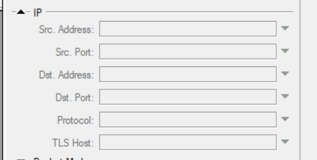

Thanks, for the answer. But i can’t set any IP filtering, everything greyed. I can only use MAC filtering…
You can use IP section only if you select MAC Protocol - IP, obviously :slight_smile:
Ahhh, there it is. Sneaky hidden option. Thank you very much!
You are welcome! :slight_smile:
