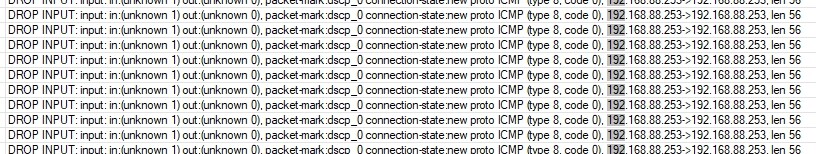

I have a RB4011iGS+ and have setup one of the ethernet interfaces as 192.168.88.253 and connected to that interface is a device with IP 192.168.88.1
I have setup a forwarding rule to pass all packets going in and out that interface (ether10). But this rule never matches, and I log the failure as shown below.
I see that the interfaces for this packet (input and output) are both “unknown” in the log. Why? I need to match my firewall rule based on source interface (ether10) but if the interface is never recognized as ether10 then the rule won’t work. What’s wrong here? Why is the interface name (port) missing?

At least pist the exact rule which doesn’t work for you.
And a detail, it might be a hint: firewall rules may be executed before egress interface is known, routing decission is made after most firewall processing is done.
Also: screenshot in opening post also hints that ping is originated from router itself, pinging own IP address … and that works entirely within its IP stack, so no interfaces are ever involved.
