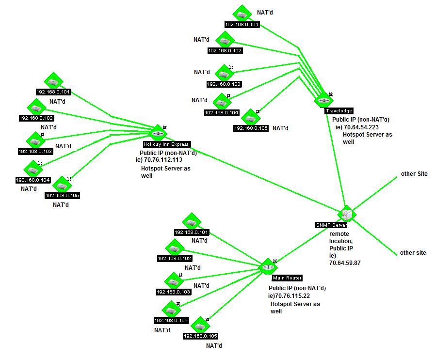

:slight_smile: Your patience is greatly appreciated, sorry to make things confusing, I hope the image will make better sense of my exact layout for my sites.
I am trying to understand your suggestion, please bare with me Sir. Here is the part from what you mentioned that I am not totally sure how to do:
“To do that though you will have to make different IP or VPN networks at your various locations. It is possible to add an IP range outside what your Hotspot networks use normally and then have a different network for each Hotspot location. No need for NAT’ing as these IPs will only be used via the VPN.”
Since my Hotspot server is on the Gateway(same MikroTik) at each location, what would be involved doing what you suggested for applying an IP for the Hotspot Controller?
Hope this make sense, once again thank you for your time on this.
