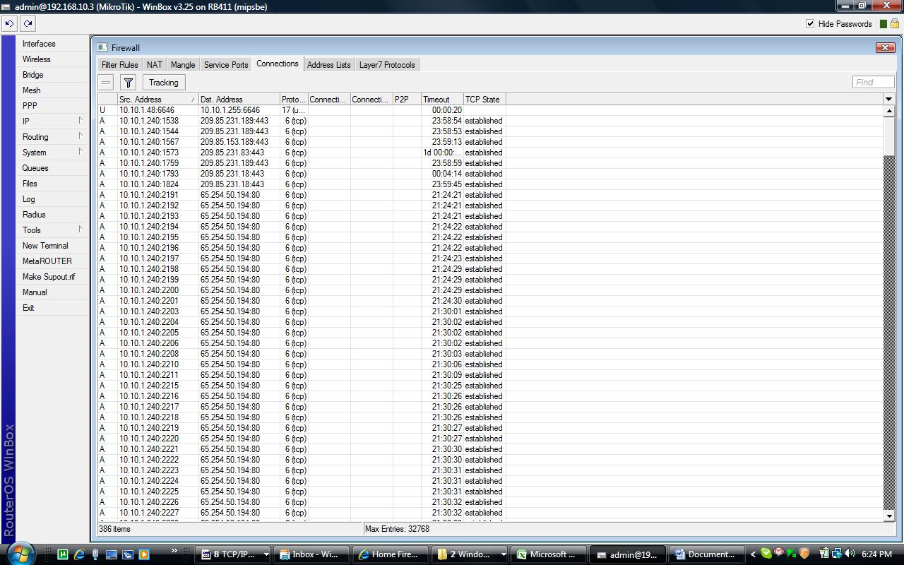

I have a 433ah at my BTS and 411 in client end. The customer is using a Netgear Router WG614 for his internal network to share internet. The WAN IP i have given to him is 10.10.1.240. The connection stops when 12-13 users get connected to the WG614 router. I have firewall configured on 433ah and 411 as per the Mikrotik Wiki to protect customers. There is no video streaming just simple mails and net surfing. Internet Speed used is 512 kbps. I checked for Connection in the firewall and found that the IP 10.10.1.240 was hitting continuously on almost every port between 1076 - 4293 in the Source Address and in the Destination Address it was 65.254.50.194:80 for all the source ports. There were like 500+ connections like this in the firewall connections of both the 433ah and 411.
Can some one suggest me what the problem can be and how to solve it.
That’s some guy really trying to load a webpage from that server.
Find him and use ‘netstat’ to figure out which process on his computer is causing that traffic.
65.254.50.194 probably belongs to some hosting service which hosts the website for this clients. All the users on thie Netgear WG614 are accessing mails and replying them or doing stuff related to this site. I had a CPE placed at the customer end b4 but they were not able to make attachments even 40.0kb in size therefore i replaced it with 411. The situation improved a bit but the problem more or less remain the same. Do i haveto run “netstat” on every single user computer connecting to wg614 router?
The idea was to locate the machine carrying that IP address and use either netstat or some other process explorer to figure out which process (application) on the machine is tied to the ports making those connections to that web server.
10.10.1.240 is on WAN Port of the Router.

I think I know why he wanted to get there so bad.
Try pinging : mail.russian-porno-portal.com
ping mail.russian-porno-portal.com
Pinging mail.russian-porno-portal.com [65.254.50.194] with 32 bytes of data:
Reply from 65.254.50.194: bytes=32 time=44ms TTL=52
Reply from 65.254.50.194: bytes=32 time=42ms TTL=52
Reply from 65.254.50.194: bytes=32 time=41ms TTL=52
I am guessing it is malware related :laughing:
EDIT: Pretty much 100% it is malware.
it looks like the IP has had a few interesting names.
flashvideodownloader.org
naked-women-blog.com
4browser.com
i have discovered flashvideodownloader running in the log of the router. i thought it might be just any application.
but i had tried blocking the site flashvideodownloader.org. How did it still hit on the mikrotik? the requests should not have gone beyong netgear.
