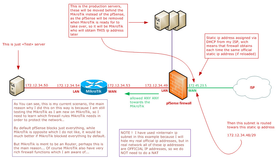

I understand what You mean yes, just for to clear whole scenario a bit I made a network drawing as You can see below.
The words can never describe what the pictures can ![]()
I assume that You will understand this scenario once You see the drawing.
Ah. Now I get it. Yes you want to run in bridged mode now and then routed mode when you replace the pfsense box.

have just tested the bridged mode, and it works just fine ![]()
Will run it in bridge mode until I remove the pfSense, then I will run a routing on MikroTik just as I do now on the pfSense.
