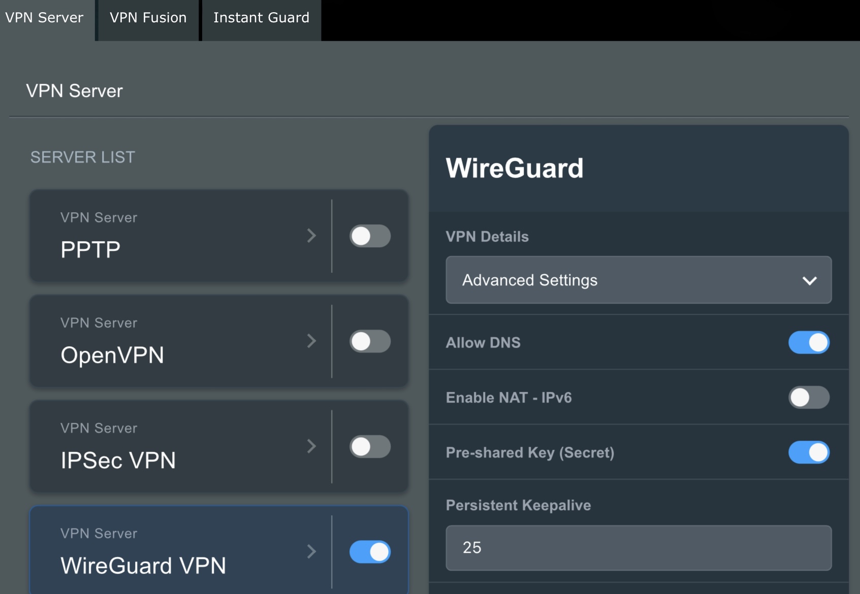

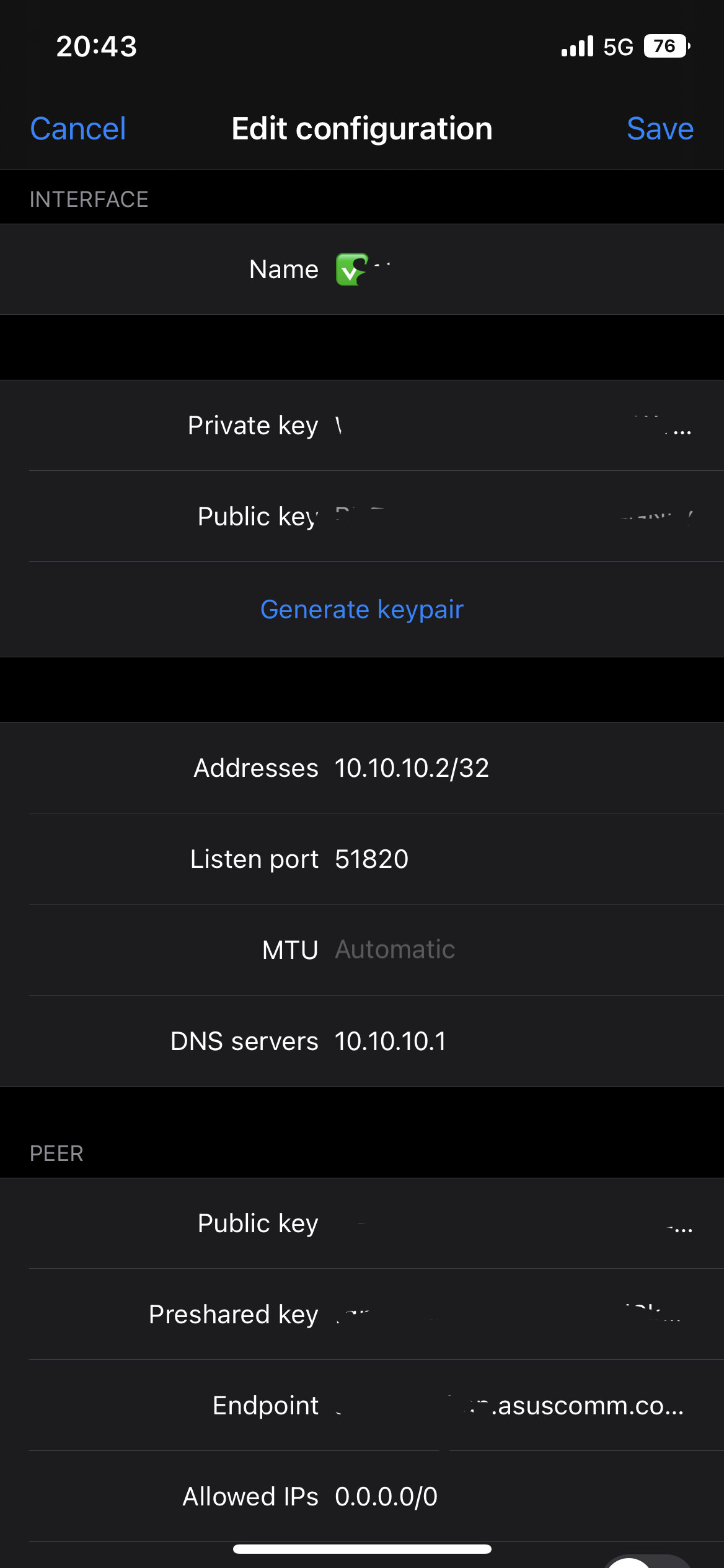

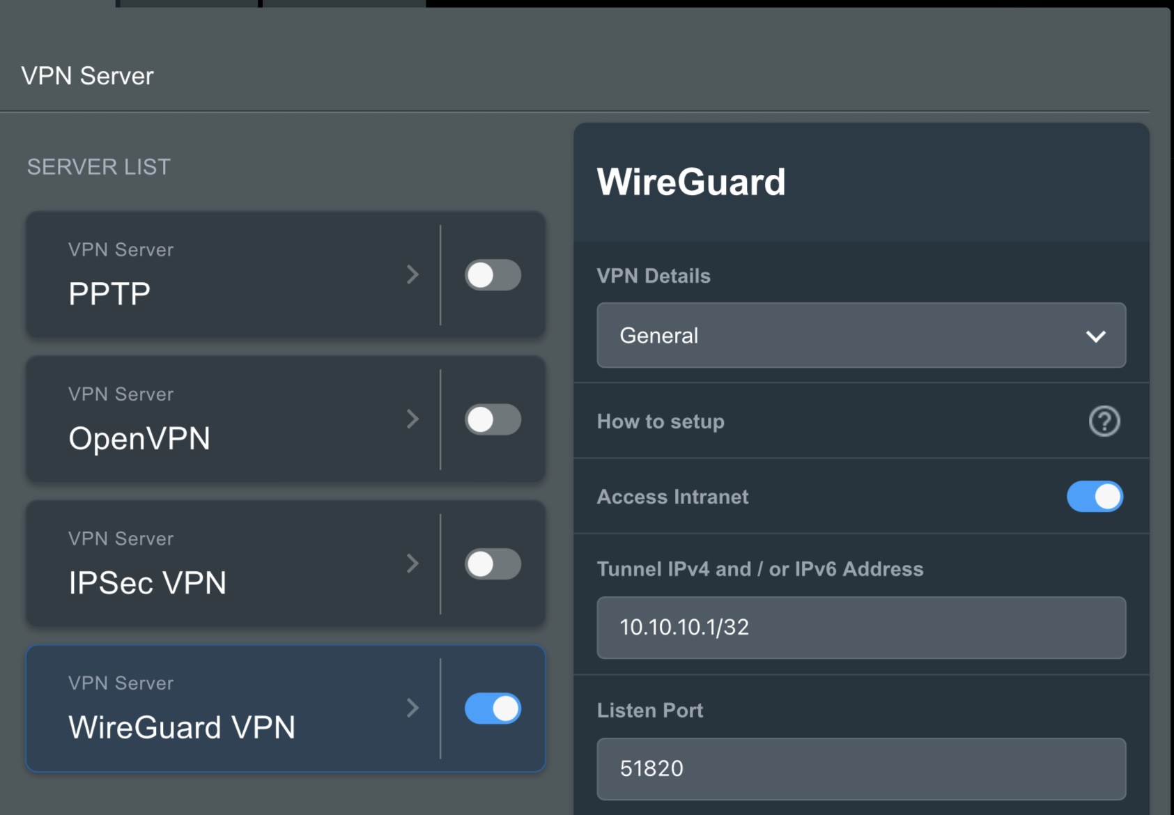

  1. Snapshot of IPHONE wireguard settings when connected to Asus
  2. Snapshot of ASUS wireguard settings

The IPHONE connects anywhere to the ASUS via wireguard be it through a wifi coffee shop, hotel wifi, or cellular signal or through wifi at home.
Which is a logical conclusion.
If that is the case, then this thread is not relative to mikrotik and thus cannot provide any assistance.
The decision for your phone to go out wireguard and not to the subnets of the MT router IS A PHONE ISSUE not an mt issue.
Presumably, the smartphone is on one of your LAN subnets when connected via wifi, and as such follows the firewall rules that pertainb to the LAN.
So when you want to access the router subnets and or internet through the local MT router, do not turn on the wireguard application!!
