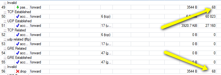

i cant find the post, but mikrotik suggested putting invalid rule BEFORE established rule, because certain established packets are considered established when they shouldn’t be. i will see if i can dig up their explanation. invalid should be before established to weed out hackers that modify packets.

i know that a packet won’t have multiple states, but the established rule doesnt always match only established packets. it can also match invalid packets. let me see if i can get a plain and clear example pic of it…
Right now these match, I will let it run for a day and see if they get out of balance.
I could swear that in the past there were situations that they acted differently. If I run for a day and they still match I will have to eat my words : )
