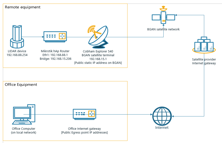

Here’s my attempt at a network map - I hope it helps explain the setup
EDIT: In the diagram, I’ve accidentally swapped ether1 and bridge, they’re meant to be the other way around.

Very nice!
Please post the current config on the MT device.
/export file=anynameyouwish ( minus router serial number and any public WANIP information )

You don’t have the correct IP addresses for the Mikrotik in the diagram. On the bridge 192.168.88.1/24 on the eth 1 192.168.15.206. By the way, reassign the address to the bridge in the config, because port 2 is part of the bridge and is a slave.
To disable access for all LAN devices change the rule add action=drop chain=forward src-address=192.168.88.254 instead of the source address 192.168.88.254 to 192.168.88.0/24.
