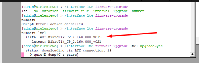

I’m trying to upgrade the LTE modem firmware (CP):
/interface lte firmware-upgrade lte1 shows installed MikroTik_CP_2.160.000_v015 and latest ..._v021, but when I run:
/interface lte firmware-upgrade lte1 upgrade=yes
it starts “downloading via LTE connection” and then fails because the LTE link drops during download.
