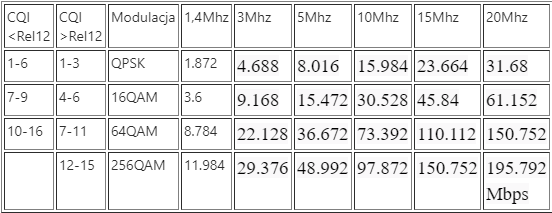

rsrp is quite good, sinr not so much, cqi 14 is approximately in the middle of the range (the best one with QPSK), so not a great throughput.

So for each SINR value, there is a combination of modulation type and redundancy ratio (Modulation and Coding Scheme, MCS) which allows to recover the original data without errors. The receiver tells this to the transmitter using the Channel Quality Indicator (CQI) value, and the transmitter uses that information to choose the corresponding MCS for data sent to that particular receiver.
There is a table for the CQI meaning, e.g. here, and a blog post summarizing the meaning of the abbreviations.

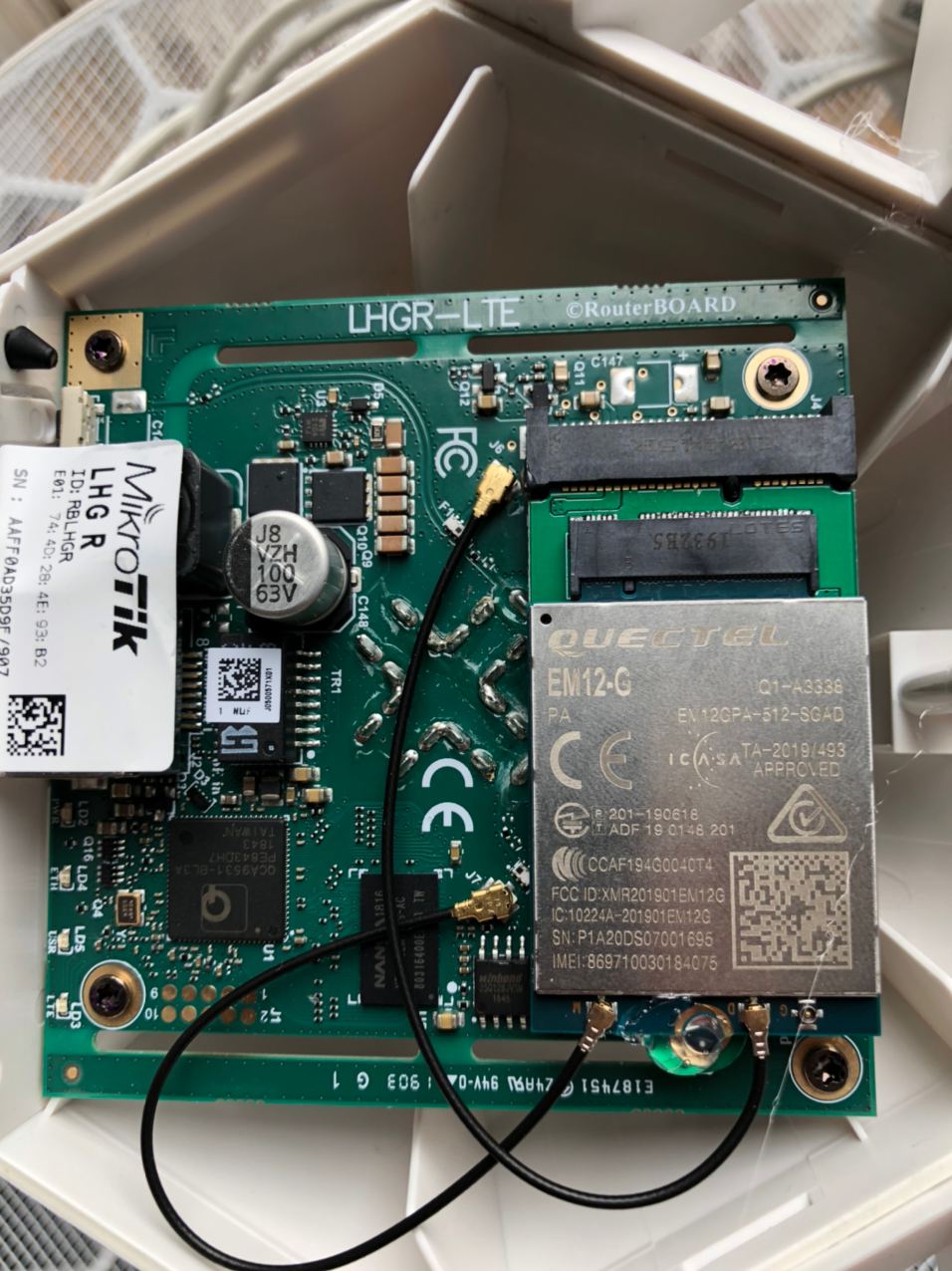

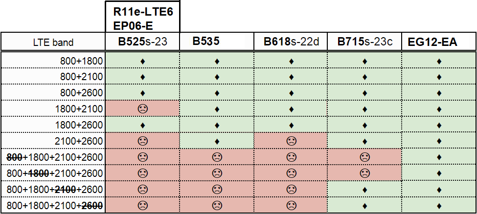

R11e-LTE6 cannot aggregate B1+3/7, all other options works and I prefer buy SXTR/LHGR without lte modem and add Quectel EM12-G who have all CA options.
