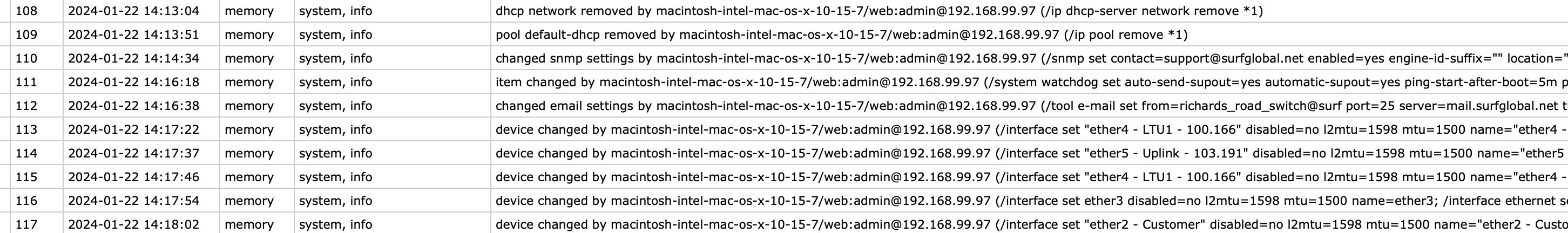

All of our routers (models RB960PGS and CRS318-16P-2S+) are stuck on version 7.11.2. When we go to router board it shows that the current firmware is 7.11.2 and the upgrade firmware to 7.12. In the resources tab it shows “version” 7.12 (stable). So, it’s downloading the firmware but not able to complete the update. We’ve never had an issue with our script running the updates until this version that the routers are stuck on. We also noticed we’re getting weird error messages under the logs tab that we never got before. We can manually update the routers with no issues. We’ve tried manually updating some routers to 7.12 to see if the script will run and update them 7.13.2, but we see the same results. Anyone else have this issue or a similar issue?
It is impossible to evaluate what you do not display.
But from what we read in the screenshot of the logs,
if they are generated by the script, I assume it is poorly done.
I recommend reading and understanding the changelog of the version you are installing,
and the intermediate ones compared to the one you come from,
several times before installing any version, because this change in log verbosity was already present.

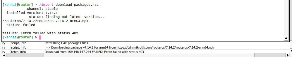

I also use a script to automatically update my router (and multiple APs using Capsman), and it recently stopped working, returning a “403” error code.
This is the script I use:

it has worked perfectly until recently with no change, but now it does this:
Is there something to do about this?

and a static /tool/fetch call:
[xenhat@router] > /tool fetch http-method=get address=cdn.mikrotik.com mode=https src-path=/routeros/7.14.2/routeros-7.14.2-arm64.npk
  status: failed
failure: Fetch failed with status 403
I found out that if you remove “once” then it start to work again
/system/package/update check-for-updates once
replace with
install
RBD53iG-5HacD2HnD is affected as well, so I believe this is RouterOS issue, not hardware related
I managed to fix the script by changing the fetch command to use the url parameter. For completion, the full script is as follows:
