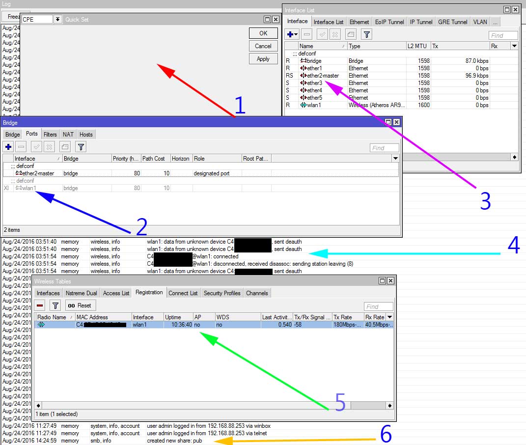

I make a screenshot where you can see my situation
  1. I did “Bridge all LAN ports” and pressed “Ok”, that’s what happened (arrow 1 and 6).
  2. Is it ok disabled?
  3. I don’t understand what can do the ethernet-master more than others.. I mean, if I connect my pc to ether3 will be master? Are just name?
  4. I have a problem with a wireless repeater TL-WA830RE, I googled but I found just a wiki page that has been deleted. How can I associate? (arrow 5).
