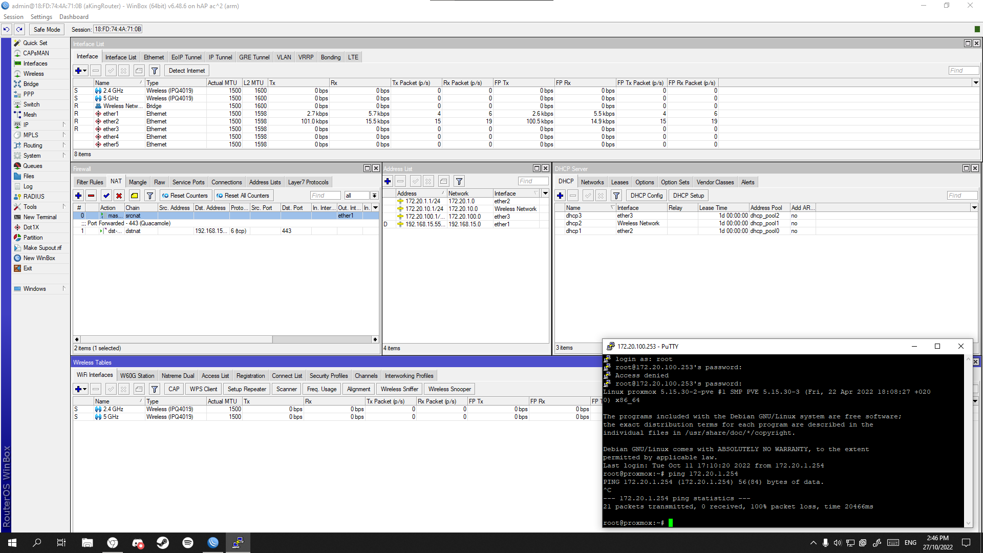

I’m new to MikroTik I worked with some simple concepts in a course and got really intrigued. At this moment I’ve got an hAP ac2 and done some general set-up with a forwarded port and a little playing around here and there.
I have 3 networks set up now, with one working as intended.
172.20.1.0/24 - Wired PC
172.20.10./24 - Bridged wireless 5GHz and 2.4GHz
172.20.100./24 - Wired Server
The only network working as intended is my Wired PC network which is able to traceroute/ping all devices outside the network but any of those devices cant ping/traceroute back to the Wired PC or any other device if outside its own network
I’ve added a screenshot of a Putty connecting to the Wired server but ping is not being able to be sent to the Wired PCs IP and the configuration file

I checked this previously, as when the wireless devices are pinged the same situation occurs and all firewalls have been double-checked for pinging, Thanks for the suggestion tho!
Thank you so much for this. I’ve used all of these methods and with the info, I’ve gathered I’m still very stuck. My TCP connections were coming through on the Logs same with the Pings when doing the logs they came through as
forward: in:ether3 out:ether2, src-mac 5c:b9:01:3b:ea:00, proto ICMP (type 8, code 0), 172.20.100.253->172.20.1.254, len 84
to me, this seems that the ping was somewhat successful but in the same case the Proxmox was still coming back as unsuccessful. Is this me not understanding the Log?
With the traceroute and gateway that’s all coming through the hAP as the gateway and going to it first and dropping when reaching the gateway.
