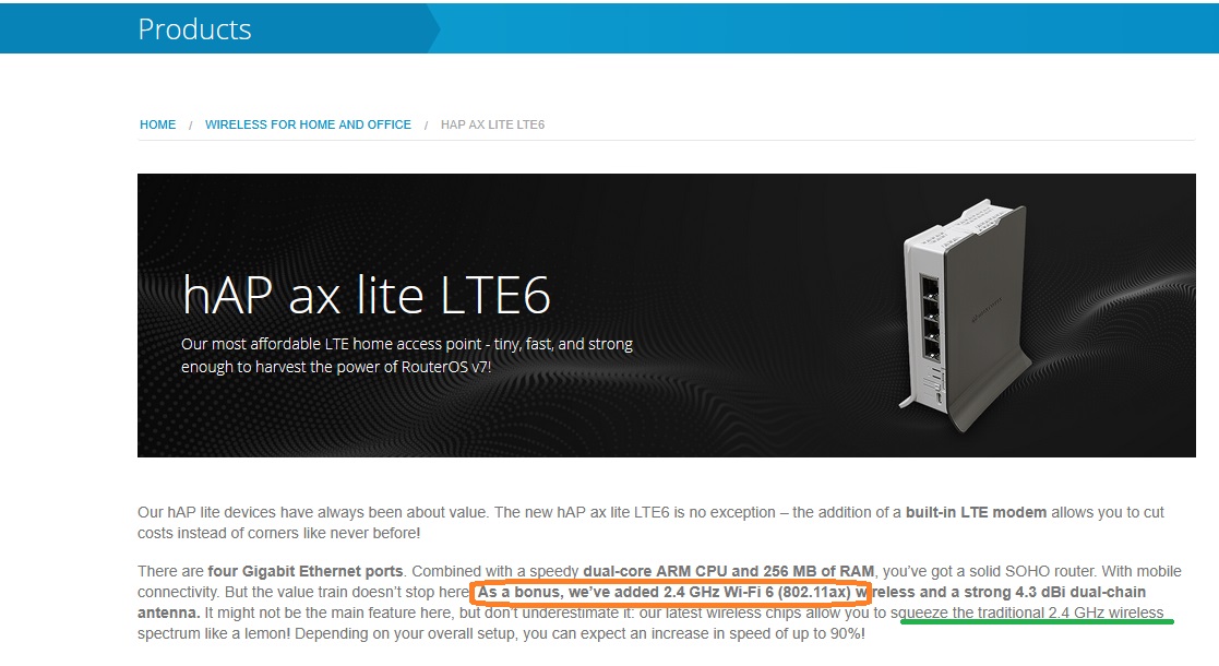

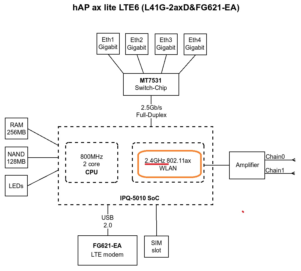

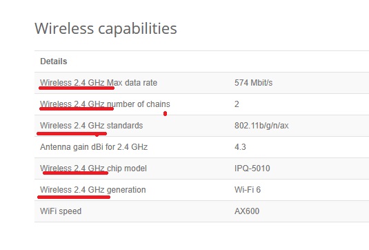

4- AX Lite LTE does NOT have 5GHz radio.
It’s clearly indicated in the specs for that device.

Further, how on earth could you know that the unit does 5ghz.???
Next time do your research and also lite maybe actually means, no frills and less than ‘normal’
