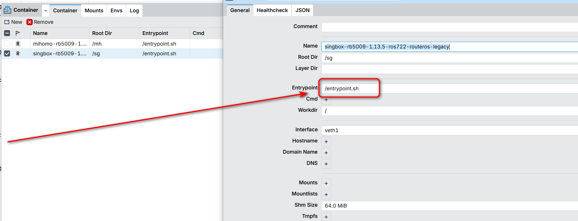

Many thanks to CGGXANNX and Gundolf for their replies. The issue of container tun0 failing on version 7.22.1 has been completely fixed, and the latest versions of the singbox and mihomo images have been backed up. They can be imported directly and will work. The shared directory contains a detailed workflow document, RB5009-ROS722-TUN-Final Instructions.pdf, which you can check out if you're interested.
Additionally, I recommend using a node conversion tool to generate the configuration file:https://sublink.works
mihomo For tun mode, you need to add a tun configuration endpoint; simply paste it below the DNS section. The code is as follows:
entrypoint=/entrypoint.sh,No other settings required:

This is the complete IP rule startup command for entrypoint.sh. If you are creating your own image, you can refer to it directly:
#!/bin/sh
set -eu
LOG_FILE="/startup.log"
log() {
  printf '%s\n' "$*" | tee -a "$LOG_FILE"
ensure_ip_rule_priorities() {
  while ip rule show | grep -Eq '^1:\s+from all lookup local'; do
    ip rule del pref 1 >/dev/null 2>&1 || break
  done
  while ip rule show | grep -Eq '^2:\s+from all lookup main'; do
    ip rule del pref 2 >/dev/null 2>&1 || break
  done
  while ip rule show | grep -Eq '^3:\s+from all lookup default'; do
    ip rule del pref 3 >/dev/null 2>&1 || break
  done
  ip rule add pref 200 from all lookup local >/dev/null 2>&1 || true
  ip rule add pref 2147483646 from all lookup main >/dev/null 2>&1 || true
  ip rule add pref 2147483647 from all lookup default >/dev/null 2>&1 || true
: > "$LOG_FILE"
log "[start]"
# fake-ip 开启才需要
ip route add 198.18.0.0/15 dev tun0 >/dev/null 2>&1 || true
log "[launch sing-box]"
exec /bin/sing-box run -c /config.json --disable-color
RB5009UG+S+ 7.22 singbox+mihomo Download
