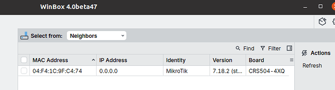

I have a CRS504-RXQ-IN that I had to do a factory reset of. (See attached screenshot). I discovered the hard ware that this more or less bricks the device.
How can fix that and restore the IP address of the CRS504 back to its default of 192.168.88.1?
If I have to resort to console commands, I’ll need the exact sequence of commands.
Does Mikrotik monitor these forums, or are we on our own?
– Doug
Just click on the MAC address of the switch and log in using the MAC instead of the IP. This is a common operation with Winbox.
Double-click the MAC address in WinBox and login using that MAC address. Once inside, go to System -> Reset Configuration, enable only Keep Users and Do Not Backup. Click the Reset Configuration button and wait for the CRS to reboot. The switch will be back on the default configuration with the ports in a bridge bridge and bridge has 192.168.88.1/24 assigned.
