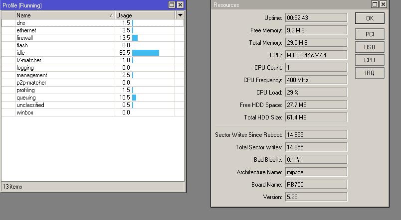

Hello

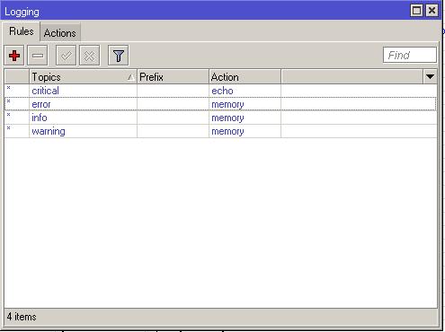

logging to disk not configured,
graphing yes but not stored on disk

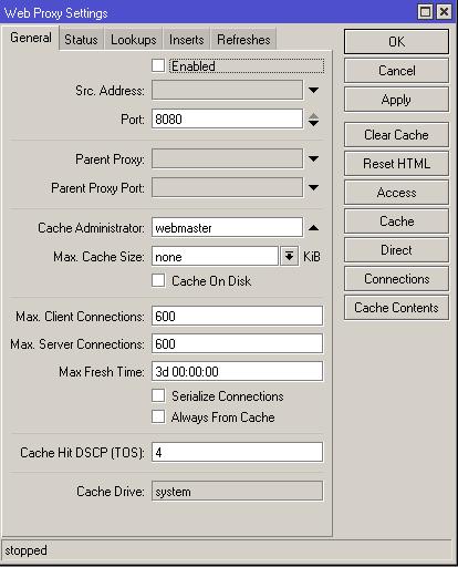

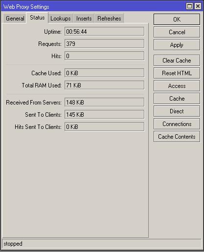

proxy is not enabled but it shows running.

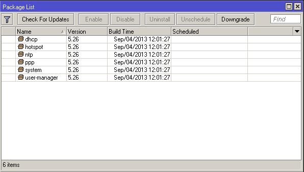

please check screenshot.
2 more attachment
