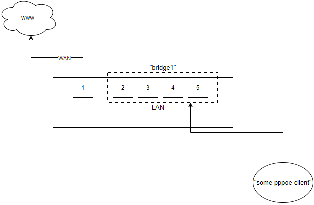

If your physical WAN interface (e.g. ether1) is part of LAN bridge for some reason, then yes, LAN broadcasts will egress through that bridge port. If by saying “PPPoE client” you mean that client is running on 3rd party device in LAN side, then this is indeed the case … and you have to make RB to work in “bridge mode”.
If physical WAN interface is not part of LAN bridge and thus doesn’t belong to same L2 domain, then LAN broadcasts should not be leaking towards WAN.
Unless you try to run some multicast helper (mDNS or some such) which is there expressly to break L2 barriers in the first place.
hi
if this is the topology/setup…
then there will no broadcast forwarding to WAN (1) naturally
Neither will PPPoE work (because that requires L2 transparency ... at least as far as PPPoE L2 protocols go).

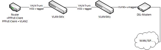

I meant such a topology, the Router (PPPoE-Client) is not in the same room where the DSL-Modem is located:
VLAN2 = the “home-network”
Will Layer2-Brodcasts “leak” via the Modem to the ISP? Remeber these Broadcasts are normal stuff (like ARP…) without a PPP-Header. I think they will reach the ISP but get discared because they have no PPPoE-Header??
If you configure VLANs properly and with all the security properties enabled (frame-types and ingress filtering), then LAN will be isolated from VLAN2 (kind-of WAN). That’s particularly important on the VLAN-SWy which is border device of your network. But all devices gave to be configured properly (VLAN-SWx, router), any could “bleed” traffic across (V)LAN boundaries.
So LAN broadcasts should not bleed towards ISP modem.
And, BTW, having VLANs … your topology is far from “flat”, so the title of this thread misleads us :wink:
You missed this part :slight_smile: :
VLAN2 is not a special “WAN-transfer-VLAN”. Everytihng is in this VLAN, printer, PCs, Laptops… and the DSL-Modem.

In this case yes, LAN broadcasts will reach ISP modem … because ISP modem is part of your LAN. There are no ifs or ors or buts.
Whether your LAN is reachable from internet … you’re at your ISP’s mercy I’m afraid.

From the technical perspective it doesnt matter, a VLAN or a LAN. Both are a single Layer2-Broadcast domains. But you are right, my drawing is in this way misleading (a bit :wink: )
@sindy, thats exactly the point! :folded_hands::folded_hands: From your answer I assume L2-Broadcasts are being forwarded to the WAN without filtering? Unfortunately my DSL-Modem doesnt allow me to do a PCAP-sniffing whats going out the WAN-Port.
The modem is in the same network/L2-Domain as the PPPoE-Client. So I assume every (regular) broadcast is going out to the ISP (but without PPPoE-Header). I assume further it gets discarded, because the is not PPPoE-Header. But coming to the point: In such a setting Layer2-Brodcasts leak out to the WAN?
