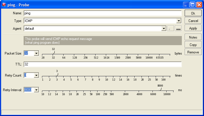

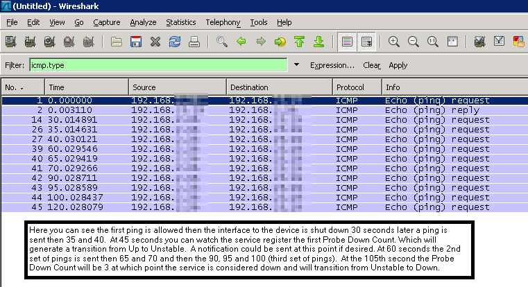

The ping command is configurable just open the probes panel or double click on the ping service. You can modify the retry count and the interval. I watched it work in wireshark. A single ping is sent every probe interval (probe intervals can be set per device, per map and globally) and if there is no response it will attempt to retry based on the ping Retry Count. If ping Retry Count is reached then the failed probe count is incremented. The device will not be “down” until the Probe Down Count is exceeded.
So if you have ping Retry Count set to 3, a ping Retry Interval of 5000ms, a Probe Interval of 30 and Probe Down Count set to 3 when a device fails it will take 15 seconds after the first ping for the ping probe to register one Probe Down Count and the device will show down at 105 seconds.
