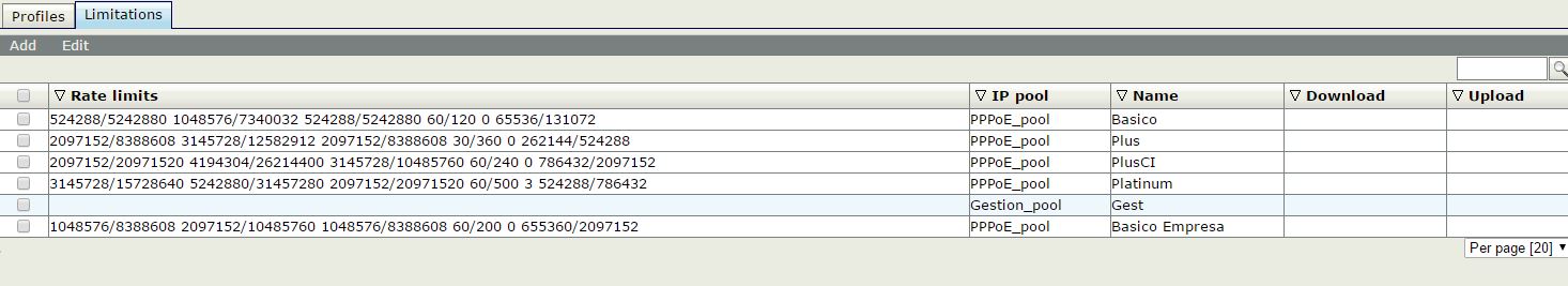

Also using a custom queue type - pfifo, Queue Size =10 packets for pppoe server
Perception of a fast network is very important regardless of what package they have sign up for, so to this we use short term traffic bursts, most customers generally don’t check speeds until they notice a connection has slowed down and we are trying to ensure they don’t have a reason to complain!

Do you use simple queues at the PPPoE AC to limit speeds?

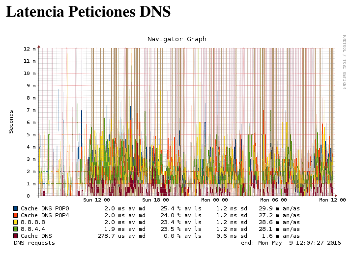

Regarding DNS cache I meant deploying a recursive resolver DNS cache locally. Google services can change rather quick, so TTL is something to specially watch out for while caching their records.
The difference of using google DNS or provider DNS vs a local, fast recursive cache difference can be of several orders of magnitude; and this is what all customers routinely use of the network starts with everytime:
(Cache DNS POPx = RouterOS DNS using the local recursive DNS Cache)
DNS requests are resolved by the local cache in 1/8th of the time using external DNS would take. This means slicing out 1,750ms of all requests, and more important: you’re optimizing this traffic, which is amongst the most critical for a smooth, snappy network User Experience, if not the most important.
