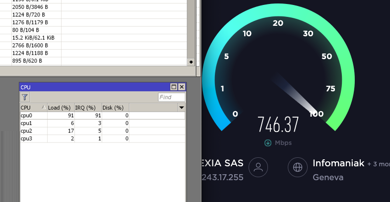

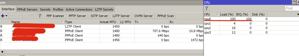

When I do throughput tests on my link, I don’t go beyond 800Mb, I noticed that the cpu0 was at 100% (see attached), however the other 3 are not working.

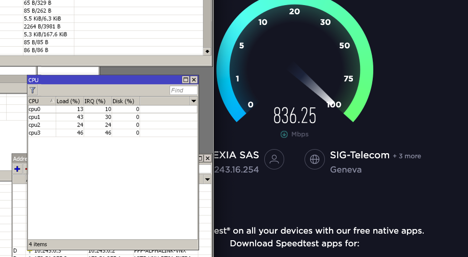

I passed the delivery of the link in IP on the interface and I don’t have the same problem, we can see the CPUs that share their load (see attached).
I have the impression that multi-threading is not managed when we switch to PPPoE.

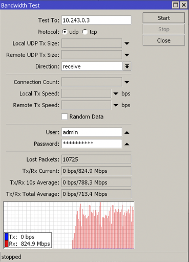

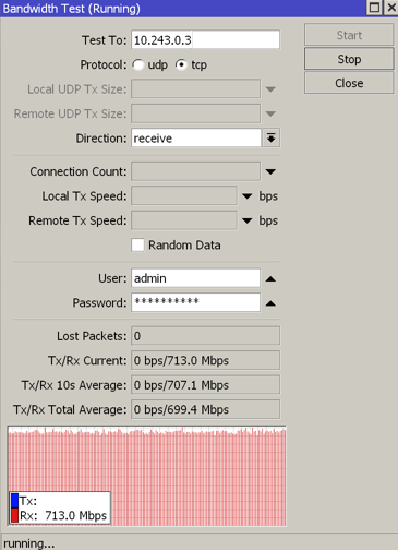

I’m doing the speed test between a mikrotik CCR1036 port 10Gb and a mikrotik RB4011 port 10Gb
I use the Bandwith test application (see attached)
If the device you test generate also the traffic…
Try UDP, is less CPU consuming during test.
not much change
824,9?
I say 825Mbps on previous post, all is right…

Your observation is very correct, PPPoE activities are done on 1 CPU-core. Always have, and probably always will. (not only on RouterOS but eg. OpenWRT, BSD too etc)
So you would benefit from a very high-clock rate to further increase this.
On these more 1Gbps (and up) links … move away from PPPoE and turn to DHCP-82 with an ISP that supports it.
Apart from that, when aiming for these speeds make sure you try to use “fast-path” as much as possible. There are several “dependencies” that might break fastpath and have much more CPU involved in the traffic-processing. This will severly limit throughput.
