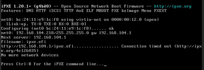

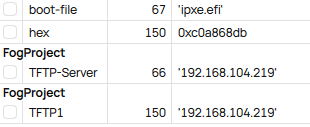

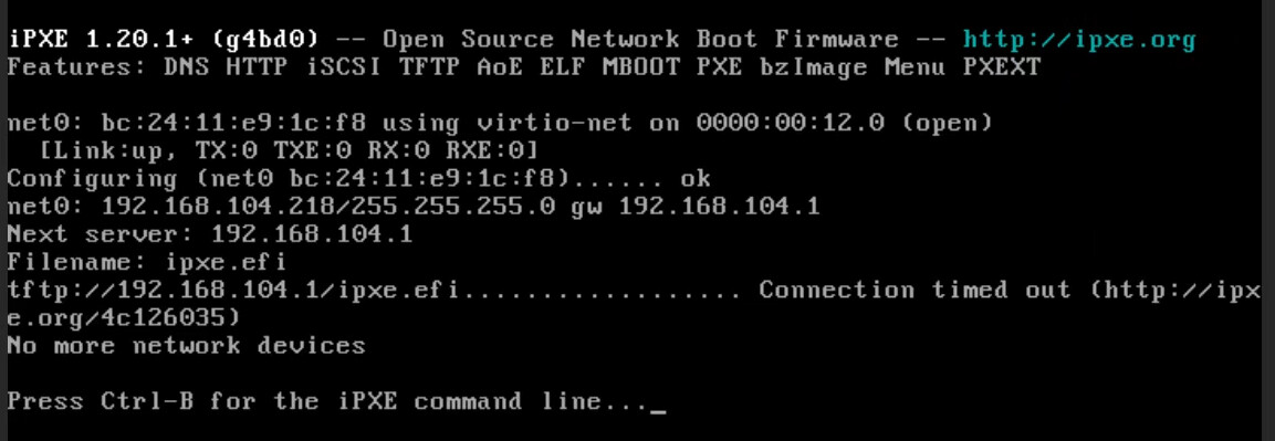

Can’t get the Fog Project server to cooperate with Mikrotik. I got the Fog server on 192.168.104.219, but PXE boot (Empty Proxmox VM) tries to open the .efi file from the gateway IP 192.168.104.1. Both are on the same VLAN. Tried multiple DHCP options, but none of the server IPs seem to work
