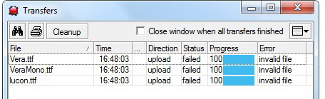

I got error when upload font @!#!%
I had this problem on a v4b3 Dude server that I uploaded a 3.6 backup. Note that 3.6 backup does not work on 3.6 Dude. Via the Dude interface things appeared normal, but on the map export (either automated PNG or clicking map on the WWW interface) gave me no words, just green boxes.
I took DroidSans.ttf (this was from the Android SDK, a readily available TTF) and uploaded it to the root dir of files. Specified that and fixed it.
FYI: android-sdk-windows\platforms\android-3\data\fonts
