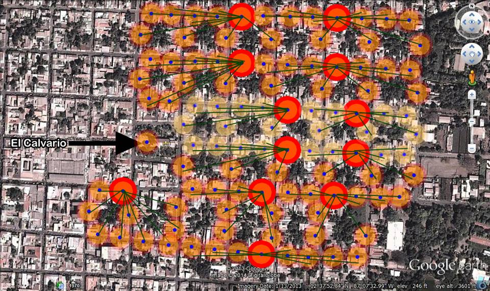

Great information guys… I love MT also and i have been doing Apartment complexes for a long time. Year 2000 I setup my first apt complex with orinoco ap2000 and hyperlink Tech antennas. It was fun and at the same time a beautiful nightmare. Anyway I learned that the point to do a great wifi in apt complexes is to put more AP at the required distance. So this is what am thinking to do in My home town. I will stick to my number one equipment MIKROTIK, I will use the Basebox 2.4 every 40 meters apart with 2 9dbi l-com rubberduck antennas. I will use Static WDS to share the internet. I think this is my solution for everyone to get an excellent signal and the network be a stable one. Attachd is a picture of how I am thinking of doing this. I will use 5.8ghz for BH on one out of 6 APs rest is wds. This is my primary plan. Treated like a huge apartment complex.

That definitely looks like quite the undertaking. Its way too involve to be properly validated on the forums, but there are some suggestions that can be made. First, I would strongly advise against the WDS solution. Second, consider using the 5GHz band to augment the 2.4GHz APs. That will improve your frequency re-use plan. Lastly, instead of doing this like a big apartment complex, I would try to build this out more like a WISP. I would use dedicated BHs and take advantage of the opportunity for redundancy. I would use OSPF for sure.
The picture didn’t really explain the difference between the type of circles or where the Internet feed(s) will be, but with the number of users this system will likely handle at any one point in time, I would definitely step it up from a typical apparment complex type installation and use a more commercial approach. I hope that helps. :slight_smile:

Ok to explain better the diagram, I will have on top of the church at the left hand side a basebox 5ghz with two radios, one its to connect all the red dots which will be a basebox with 2.4ghz for the “supposed wds” and a 5ghz for back hauling.
I do not want to make it like a Wisp, meaning I don’t want to setup any cpe on clients side, that’s just to expensive since in Nicaragua you pay $200 per each wireless link. By having users connect with their own mobile devices.
If I don’t do was how am I going to share the internet with all other bridges? Static routes?

Red aps are internet access links
All others are clients hotspot 2.4ghz
Thought I was going to use was but awaiting on suggestion on how to do the internet sharing..
Ok, that makes things a little clearer. I’m still confused about your last question though. As I understand it, the dark orange spots have an Internet feed there and the lighter ones are essentially bridged back to the main one? Is that what you doing or am I still missing something?
