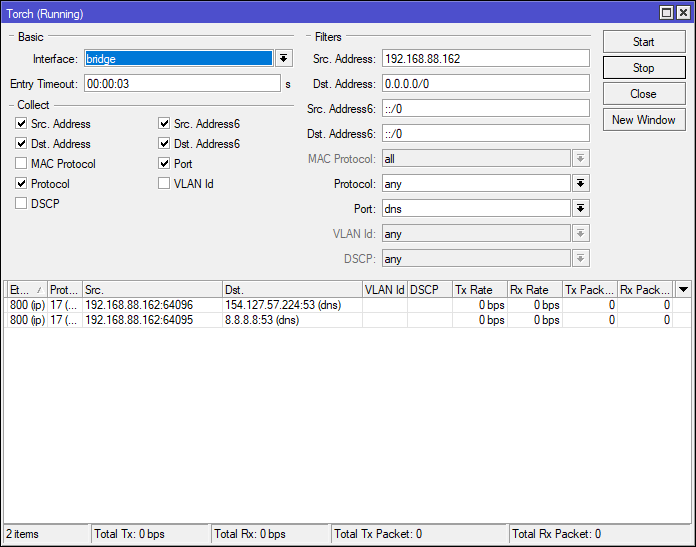

IP below is for the PS4 (different mikrotik)
Does not work as that is done already, netflix is hardcoded to use 8.8.8.8
The bridge is your lan bridge? Then that torch doesn’t prove anything, as it’s show the traffic client sees. Natting happens after the packets are received on the bridge.
If you want to verify that: try logging in forward table.
This proves what the torch sees. Despite the nat entry, Netflix is still getting through to 8.8.8.8
