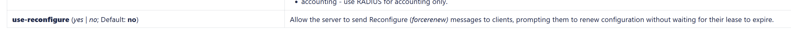

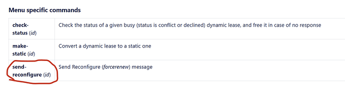

Isn’t it what you are looking for? RFC3203
I’m not sure how and if it works, but may be it could give you the right direction.
