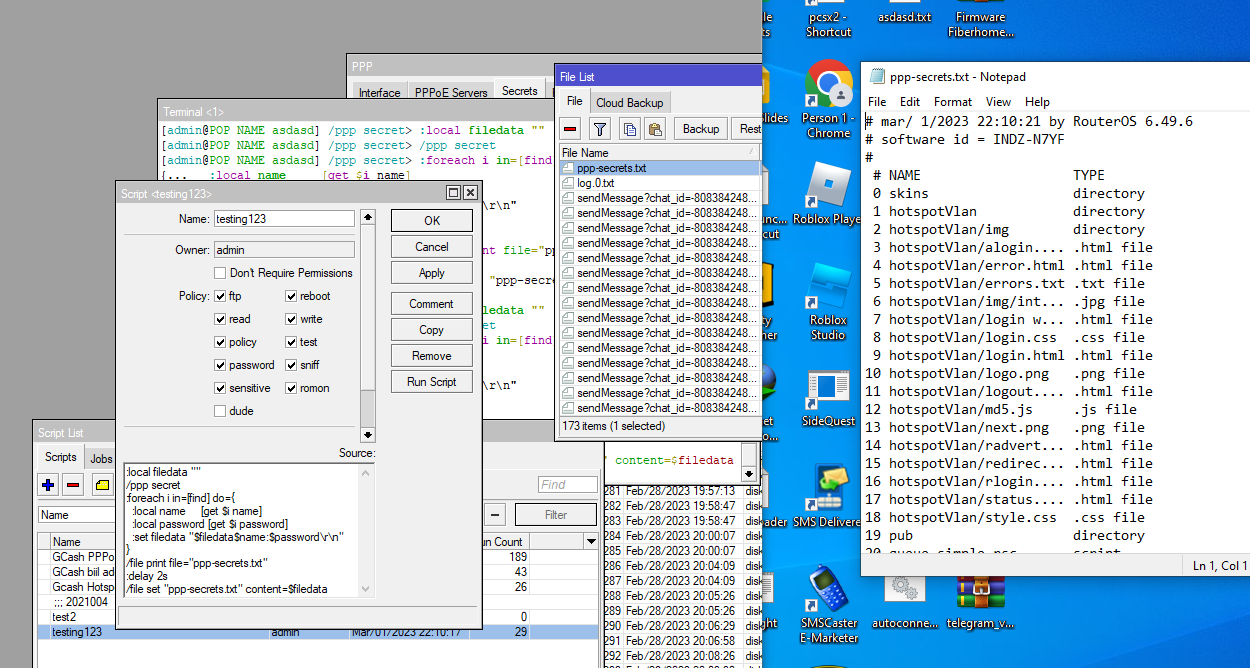

Thankyou for the reply sir, but the problem sir still insist, it does not work :frowning: . i also tried in telegram, but still i got no reply
here’s my code

The script on post #2 for me works, but how many items are?
The file created on this way can not exceed ~4000 Bytes…
On terminal, THIS work? (do not omit parenthesys { })
:local filedata ""
/ppp secret
:foreach i in=[find] do={
  :local name     [get $i name]
  :local password [get $i password]
  :set filedata "$filedata$name:$password\r\n"
:put $filedata
You can not send the data directly to telegram if you do not convert it to UTF-8 + URLencode…
And probably GET on fetch can not support more than 256 characters (not tested)
Thank you sir, It works now, but the problem the limit of the data must only 4000bytes as you said, anyway, thankyou so much!!!
