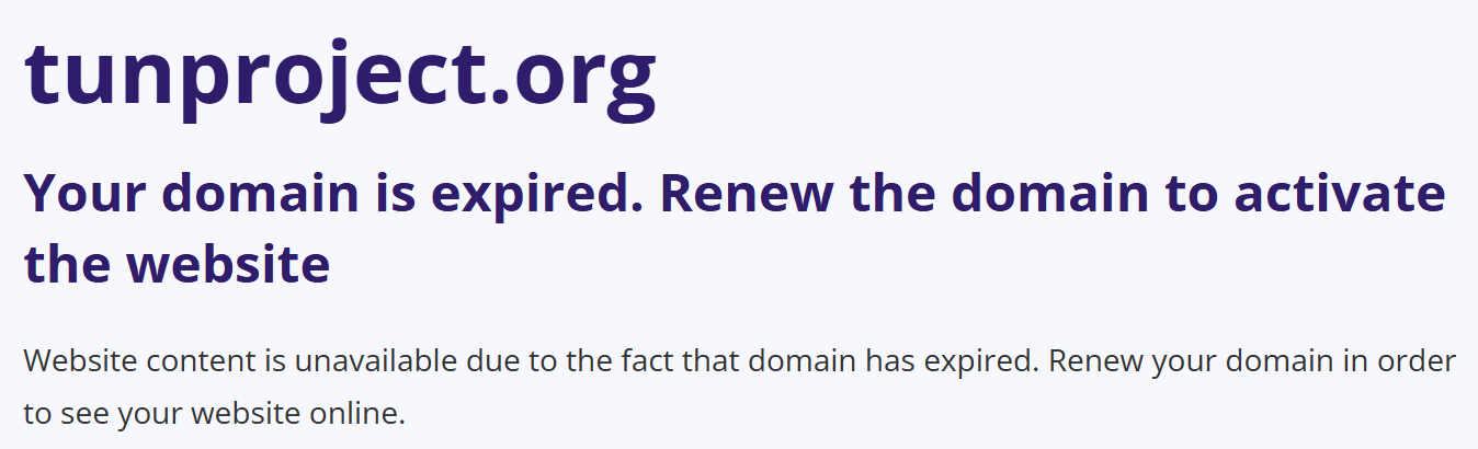

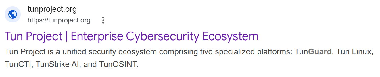

Domain Name: ``TUNPROJECT.ORG
Registry Expiry Date: 2027-07-07T15:35:56Z
Creation Date: 2025-07-07T15:35:56Z
Updated Date: 2026-07-07T15:40:08Z
Domain Status: client transfer prohibited
Domain Status: auto renew period
Registrar: HOSTINGER operations, UAB
dude probably put more effort into creating accounts in github and forum with this name than in this ai slop glorified script placeholder replacer
