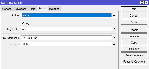

Dear Community,
I didn’t find a way to dest-nat requests to an incoming port (3051) to an other (3050) to an internal server.
Here is my conf:
When I log the flow, I can see:
09:39:50 firewall,info key dstnat: in:ether1_WAN1 out:(unknown 0), src-mac 00:1c:73:
05:0a:cf, proto TCP (SYN), 5.5.14.2:62971->18.18.16.4:3051, len 52
09:39:59 firewall,info key dstnat: in:ether1_WAN1 out:(unknown 0), src-mac 00:1c:73:
05:0a:cf, proto TCP (SYN), 5.5.14.2:62971->18.18.16.4:3051, len 48
But I can see requests on my internal server and connection is refused.
Could you please help me with this case?
Thank you in advance.
Regards,

Thank you BartoszP for your help and your time, your link help me well to unblock this flow.
I used it because of a misunderstanding about Mikrotik router…
What I used:
add action=dst-nat chain=dstnat dst-port=3051 \
    in-interface=ether1_WAN1 protocol=tcp src-address-list=***** \
    to-addresses=172.25.11.55 to-ports=3050
add action=src-nat chain=srcnat dst-address=172.25.11.55 dst-port=3050 \
    protocol=tcp src-address=!172.25.0.0/16 to-addresses=172.25.10.254
if its can help…
