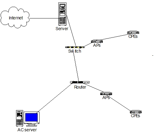

The main pppoe server is in 192.168.5.1. Most of the radios connect to APs on a switch that links to a PtP link to the server.
From that switch there is a PtP link to my router (connected to eth1). On Eth2 there is another AP for some radios near my zone.
I attached a small diagram.
I have added an IP for each subnet. I use the IP 192.168.5.3 to access it from outisde and 192.168.88.1 from eth6.

Do the radios have route to 192.168.88.88? They need either route to this address (or larger subnet like 192.168.88.0/24) or default route, both with gateway being whatever address from their subnet you added to router. For example, radio with address in 192.168.5.0/24 subnet needs route with gateway 192.168.5.3. Then they can connect directly to 192.168.88.88 and you don’t need any NAT. That’s one way.
Another is with NAT, with the rules you posted, but in that case they would be connecting to 192.168.5.3, etc.
I’d prefer the first one, it’s better to avoid NAT if possible.
