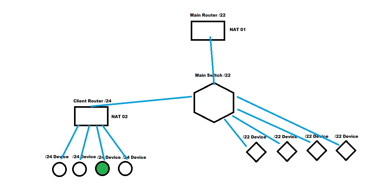

As per the attachment.
I want to incorporate the green device on the clients network to be able to talk directly to the main network past the NAT.
Only reason client has a link to the main network is for Internet. But now he wants local monitoring on his device on our side without impacting the current working state of both networks.
Ah I see; thanks for the diagram.
Does the client have a second NAT because they’re administratively not part of your organization (and also don’t coordinate addressing with you)? If that’s the case, then you probably don’t have a choice other than to port forward. It’s worth pointing out that that host won’t exactly be on the /22 LAN though. Hopefully that’s not what you’re intending by “incorporating the green device” on your /22 LAN.
If the client is more like an internal client of your organization and you coordinate address space with them, then you could just route between the two without complicating the situation with port forwarding (and you probably don’t need the NAT anyway).
Yes that’s correct. I’m not responsible for his network, so I’ll go the port forwarding route,
Thanks for the advice.
