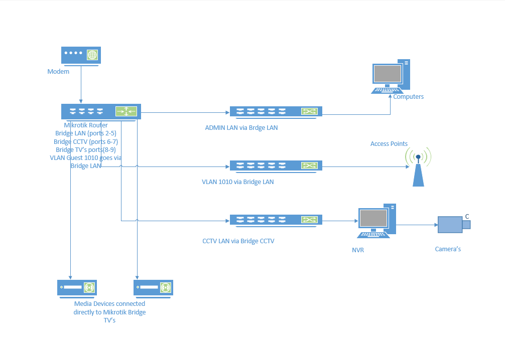

I dont need bridge for wifi !!! vlan 1010 via LAN bridge does all the job in trunk with a managed switch all is good with bridges and wifi vlan :smiley: firewall is basic with some adds to secure access and in between LAN’s you better tell me why ports are not opened?
why duplikate post ?
Means I accidentally posted the same thing twice!
Please provide a diagram as I do not understand your setup.

Bridge CCTV is connected to CCTV switch and NVR is connected to that switch so ports are opened to access this NVR remotelly via CCTV software. We have many sites with similar or the same configurations and no problems occurs anywhere .

Have attached simple network diagram
All LAN’s and VLAN are on different broadcast’s and all this is ok next is L3 , because all local networks connected to local interfaces are able to communicate until you stop it in mikrotik is done via firewall, in cisco devices via ACL’s specifically on on L3 switches. Its just to stop local networks communicating to each other all works fine no problems and extra rules on dropping forwards locally doesnt have impact on performance :slight_smile:
We are talking not about the problem i have as i have switched firewall at all deactivated all rules and ports are still not opening :slight_smile:
and again :slight_smile: mikrotik device is combination of router and switches anything connected even virtual interface (bridge) has MAC so everything is L2 connected.
Well unfortunately either I have an incorrect knowledge of L2 and L3 on MT routers or you do LOL.
Since I know my own routers functionality according to the rules I noted above do hold true, and I am relying on facts, not assumptions. :slight_smile:
In any case not part of the issue, thanks for an excellent diagram!!
So it looks like the router goes to managed switches for the most part except for the Media Devices.
You use bridges and LANS throughout and only use one VLAN (1010).
Based on the diagram I dont see any issues with your config. The only thing that is not clear is the mess of firewall rules but as you state, they work elsewhere.
What I would do is a completely separate setup USE ONE BRIDGE and vlans to separate the uses…
I cannot provide any more guidance (out of ideas) :frowning:.
