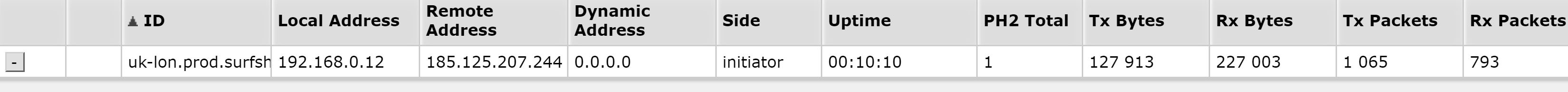

The tunnel is established but when traffic is routed to the VPN web sites are not loading. I can still ping and trace route the web server. The only web site seems to load is https://www.google.com and all http (unenctepted).

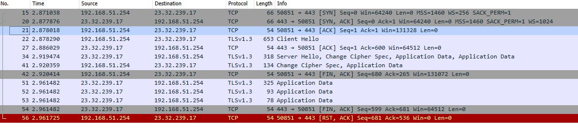

I run packet captures and the three way handshake is completed but during the SSL traffic the server is reseting the connection.

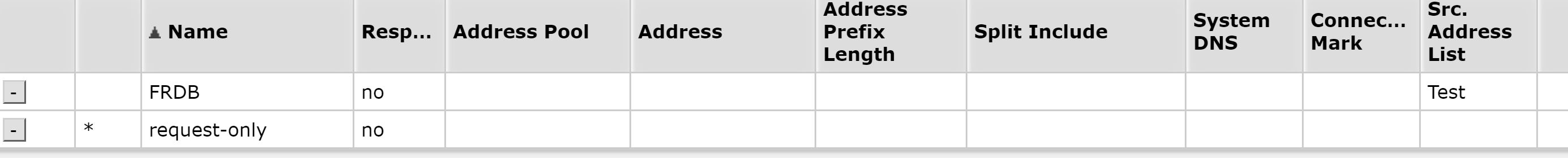

/ip ipsec mode-config
add name=FRDB responder=no src-address-list=Test

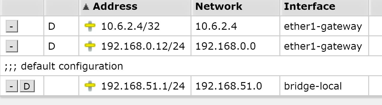

add address=192.168.51.1/24 comment="default configuration" interface=bridge-local network=192.168.51.0

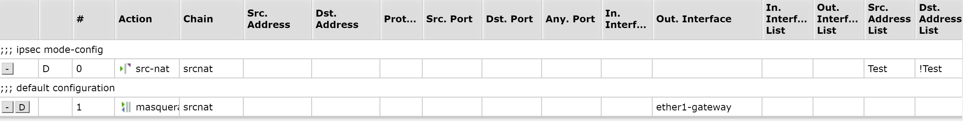

add action=masquerade chain=srcnat comment="default configuration" out-interface=ether1-gateway

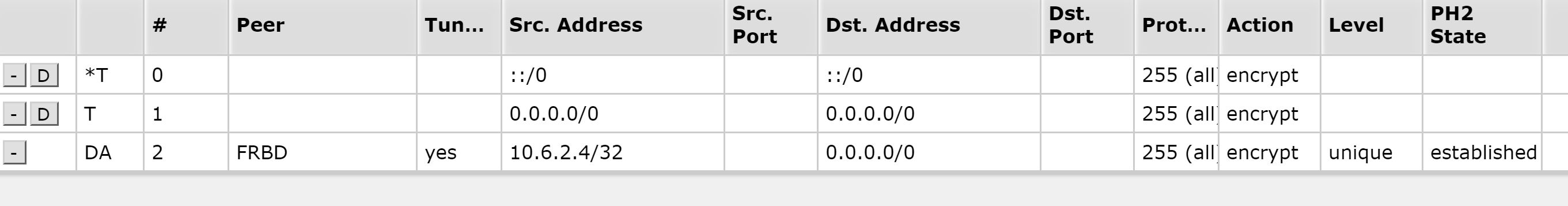

/ip ipsec policy
add dst-address=0.0.0.0/0 group=FRBD proposal=FRBD src-address=0.0.0.0/0 template=yes
