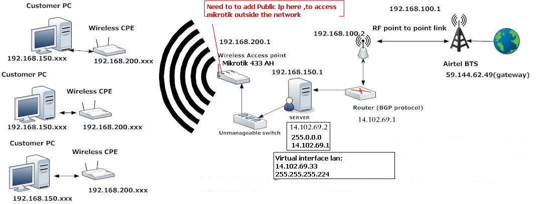

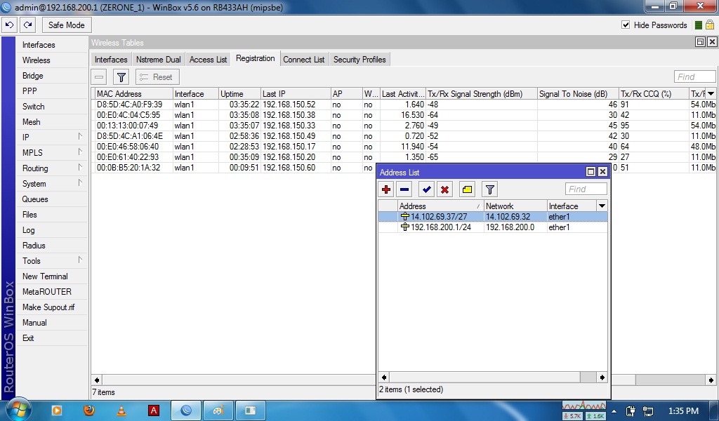

I want to use Public IP’s in my Mikrotik Access Point 433 AH.
I tried of add the public ip in ETH 1 (14.102.69.37/27), but i cant access it..
How do add ip to make available even out of the network.
MAIPU ISP Router Ip:
Ip: 14.102.69.1
Radius Server:
Ip: 14.102.69.2
mask: 255.0.0.0
gateway:14.102.69.1
Extra Public IP pool :
Ip series :14.102.69.33 - 64
subnet: :255.255.255.224
Gateway: 14.102.69.32

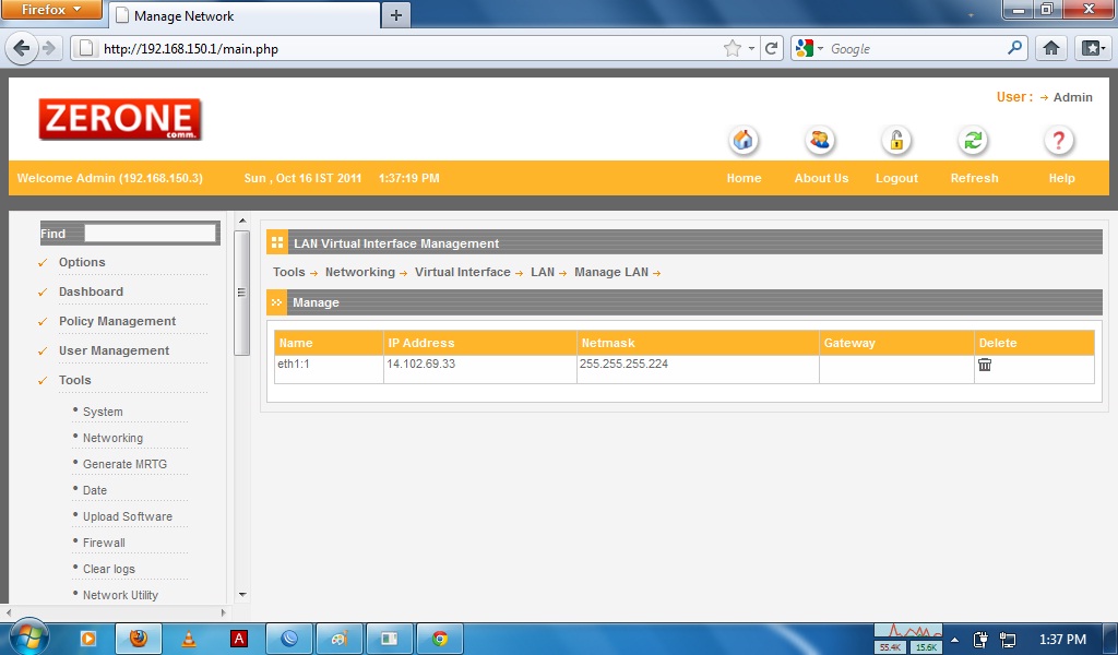

virtual interface of Radius server :
Ip: 14.102.69.33
mask: 255.255.255.224
At present, I can able to use Public IP in client end which connected to my 433 AH access point .
but, i cant use public ip in my 433AH , at present ,i use lan ip in my 433 ah (192.168.200.1/24).
Please Help me..
